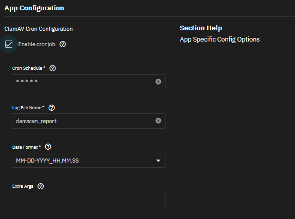

Now, that is MY setup. I believe the Truenas implementation of ClamAV has builtin functions to setup a cronjob for scans. Just enable the function "Enable conjob" and set up a schedule for it. It should look similar to this:
If i were you, i would start there.

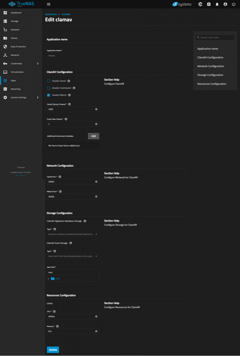

Firstly my apologies, I've only recently moved from Core to Scale and I'm still getting my head round the differences between UIs. I'm struggling a little to match your screenshots to what I'm seeing here.
I'm running TrueNAS-SCALE-23.10.1. And I can't find the Cron job bit of the ClamAV app for instance.

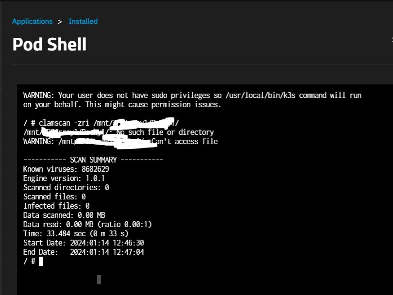

I'm also having some premission issues I think? If I run a scan from the Pod shell it just says.
I added the hostpath during the initial App setup (i added the whole /mnt/ folder) and have added the libvirt_quemi user to allow access to the datasets too.

First, I apologize for misguiding you. I just realized that I'm not using the official Truenas ClamAV app. I'm using the Trucharts one.
Try that one and you should have the cronjob options available to you.
Second, you definitely have a permissions issue. If you go to the Pod shell, can you access the files and folders manually? If not, fix that before trying to run ClamAV.
I personally run ClamAV as root (PUID=0) as i consider it a system process similar to snapshots, scrubs and replication. It may not be the most secure way of doing things but that is how i managed to make it work.

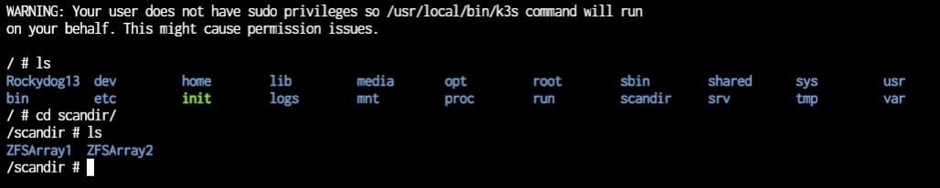

Can I sense check my understanding as I'm not really familiar with how container/ pods work other than as a basic overview.
So, in theory if I can use the Pod shell to navigate to the folders I'd like to scan at /scandir if thats readable should that mean Clamscan can access them?

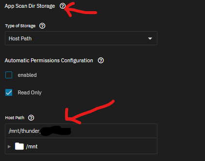

The above shows my two Pools as I currently have my scandir path set as /mnt/ Should it be the individual datasets set rather than the /mnt/ point?
I've always got the sudo privelages warning coming up too, could this be my permissions issue, if so, any suggestions?

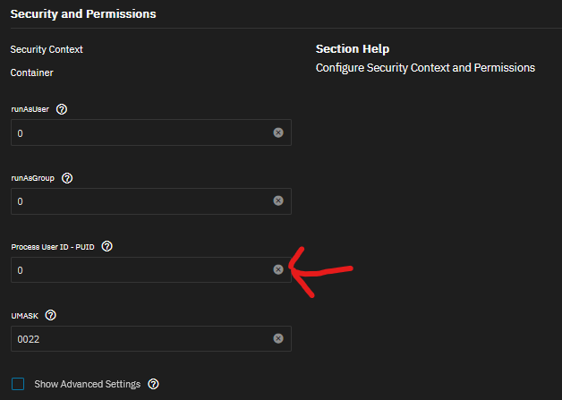

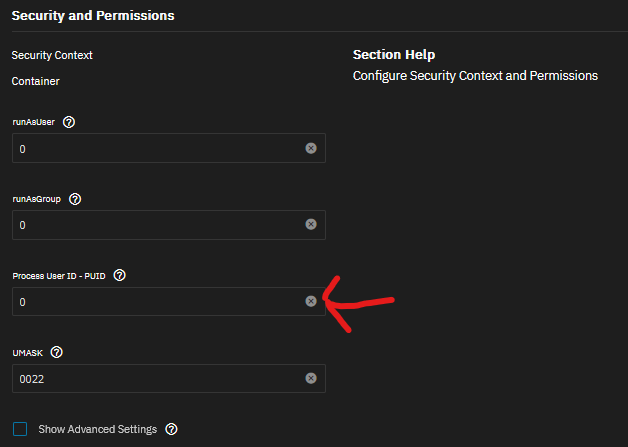

@Dysonco
"So, in theory if I can use the Pod shell to navigate to the folders I'd like to scan at /scandir if thats readable should that mean Clamscan can access them?"
YES.
I believe the advisement from Truecharts of using NFS mounts is outdated but not wrong as it is still a way of doing it. If my memory serves me right, in the past you could only mount NFS shares as local folders inside container (Not sure about this). The current version of TrueNAS now allows to mount regular system folders inside containers using "hostpath".
About the sudo warning, try running the app as root (PUID=0) and not at user APPS (PUID=568). As i said above, this may not be the safest way of setting it up, that is just how I have it in my system as i was having permission issues just like you.
