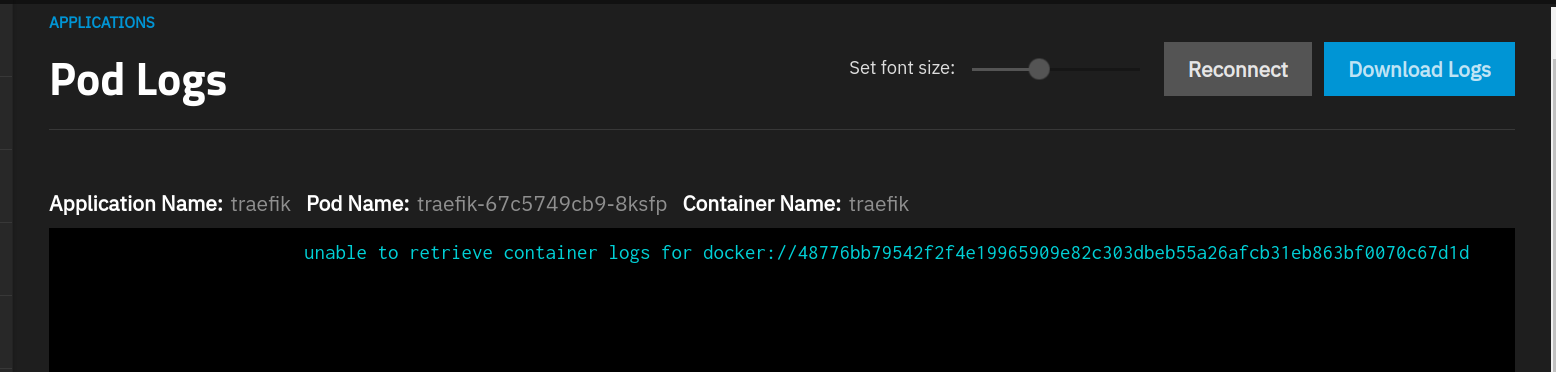

Can you show the logs and/or how the app card looks?

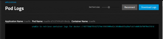

OK. Very weird. Now the app shows me no logs. I swear it gave me logs last night. Please see attached:

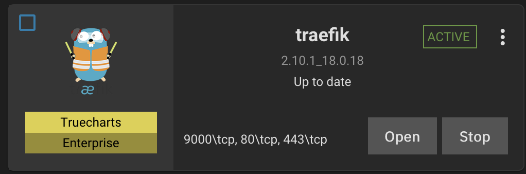

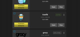

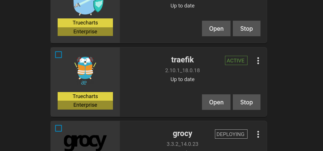

I see you have grocy in deploying status... can you stop that and any other apps that aren't starting properly?

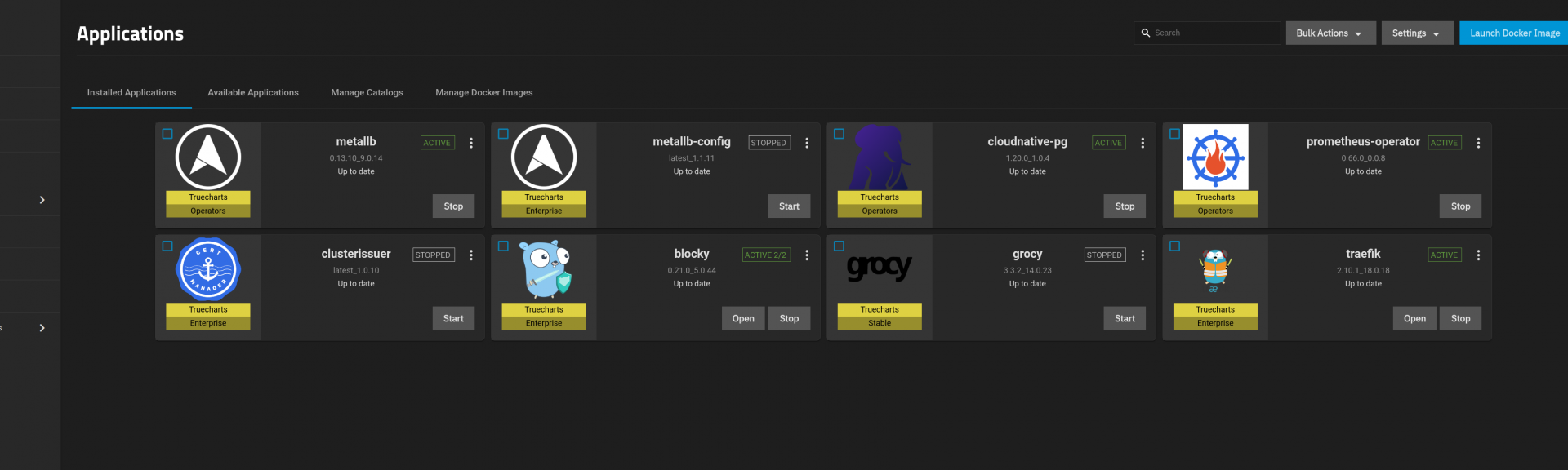

OK. Done. FYI, here are all the cards, just for clarity sake. I stopped the apps using Heavyscript. Also, @sretalla , thanks for helping me. I appreciate it.

Can you spot the difference?
9,700
What are you doing with metallb? I don't know if there's a nuance or two needed to make that all gel with traefik, but I'm sure you need to think about it if you can't use the onboard Load Balancer anymore.
9,700
And since I think we've now found the problem, I'll quote from this:
caution
Known Issue: On the SCALE Installed Applications page, the Open buttons on each app card will still open a URL to your app using your SCALE Host IP, rather than the MetalLB-Assigned IP. This may be resolved in the future.
