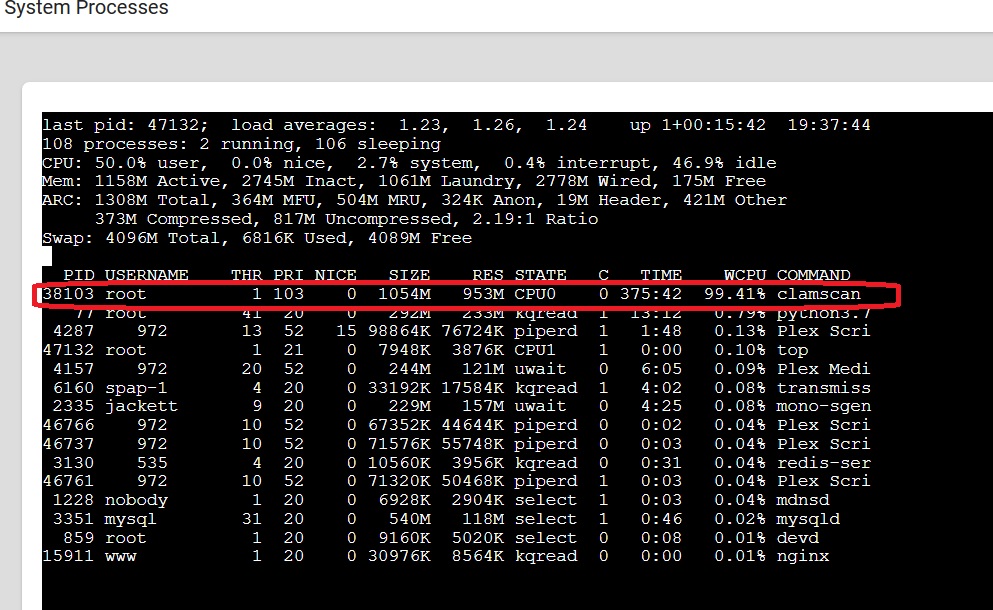

I just installed ClamAV in its own jail (pretty much following https://www.ixsystems.com/community/resources/how-to-install-clamav-on-freenas-v11.66/
but on FreeNAS 11.3 installation.
All works, but nominating large volumes to scan takes for ever *manually kicked off one of my cron jobs scanning one of my targets *about 200GB of data stored* today and 8 hours later its still running - That don't come across as right.
I also noticed some memory issues spat back from clamscan *old box with only 8GB RAM installed
Would have thought a simple scan of data should be pretty quick as well as not too memory hungry
The script kicking off the scan executes this to perform the scan on my target *parameter based*
clamscan -i -r -l /var/log/clamav/clamscan.log "${scanlocation}"
Running the same cron and scripts runs fine on smaller targets, but pointing to a large pool containing a fair amount of data it seem to struggle
Anyone with suggestions please let me know

FreeNAS running processes:

First I would try enabling clamd and replacing clamscan with clamdscan.

Anyone using ClamAV still interested in a solution? Then please enable clamd and replace clamscan in your scripts with clamdscan. That should improve execution time and CPu load significantly.
