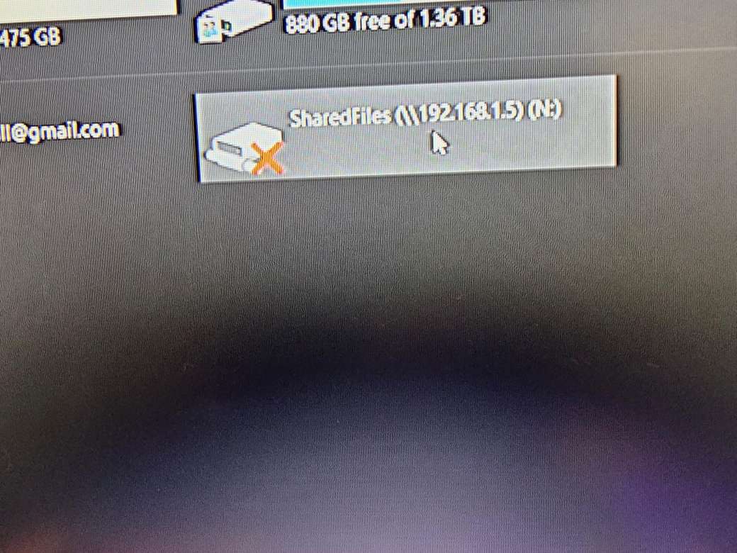

OK my patience with this system is bringing me to a boil. We set up TrueNAS on a PC basically to use it as a mass storage device for movies, music, etc. We have myself and my Partner set up on it with absolute FULL permissions to do whatever we want in this thing. Currently I'm able to access the drive one one PC, and not another despite having the exact same credentials an mapping in place for the drive to be fully accessible on any pc. I'm beginning to feel like this program is the hard way around what should be a dirt simple thing - a common access point for all of our shared movies. What is causing this to deny access from one machine despite being fully accessible to others with the exact same credentials? I'm ready to pull the plug on this and let the windows virus do the work if this continues to be a thorn in my side like this.

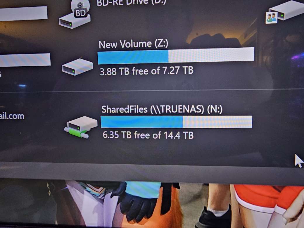

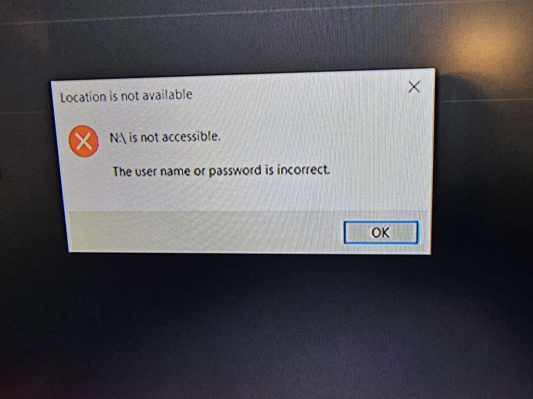

As requested. This is from two different PC's with identical credentials. same login and password for both. Literally this morning the one now giving this issue was running just fine. This is what's making me mad. It make less than zero sense to me why this issue exists.

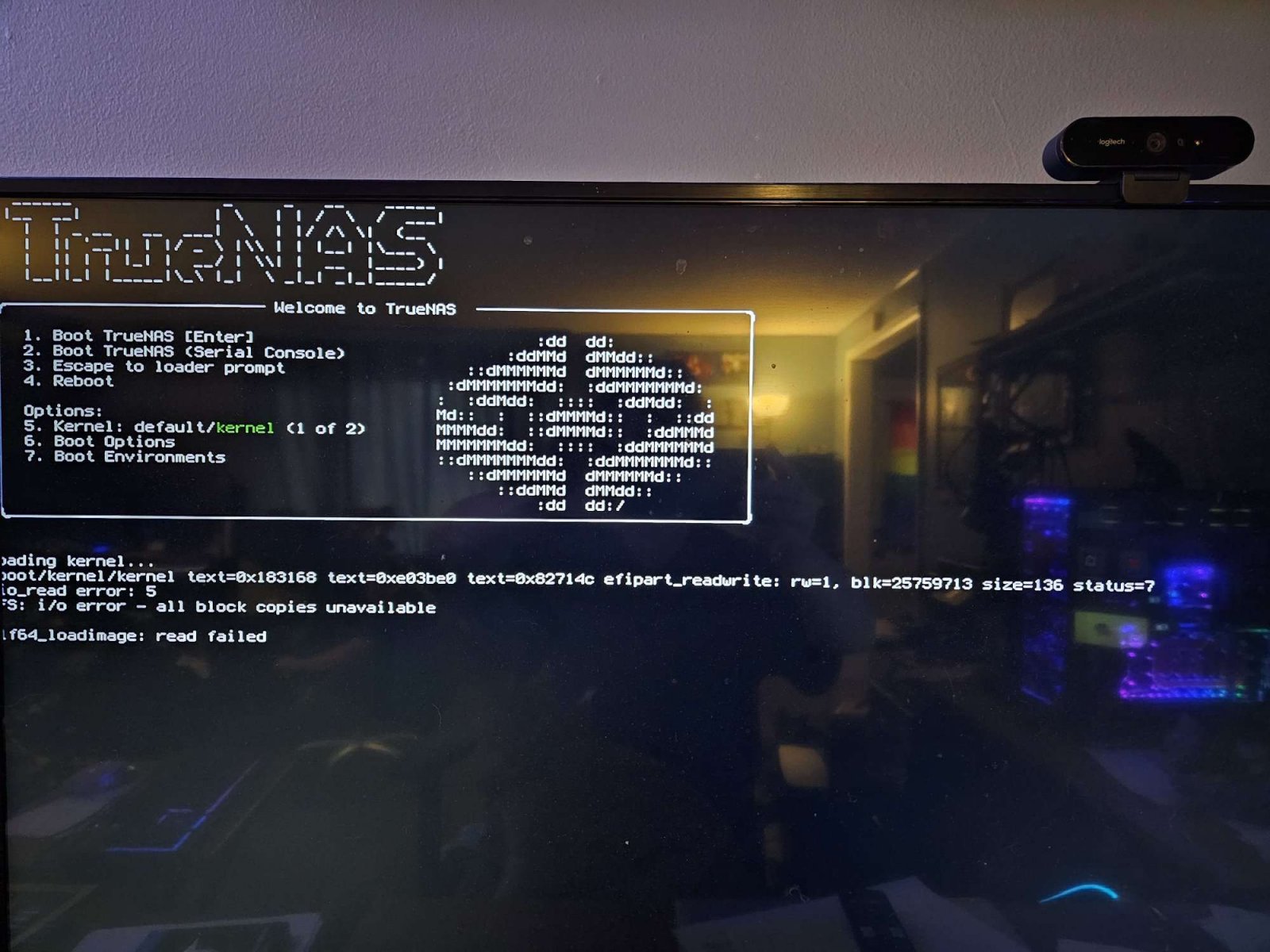

Tried to go via the web address and it just sits and spins. So, I rebooted the thing and now I get this:

It's still TrueNAS. FreeNAS ended with the 11.x release series; everything since then is TrueNAS and has its own section in the forums.
@Patrick M. Hausen, this might be part of your answer.

As @danb35 mentioned, it looks like a failed boot device in your TrueNAS. One possibility is that your first system connected the share before the failure prevented the system to function properly. Because its session is already established, it can access the resources more directly. Because of that failed device, your system was not working normally anymore and the second client was unable to complete the connection,
So first thing will be to re-install on a new boot device and restore your backed up config if you have or learn about the importance of backups if you have not. If you have no backups, you will have to re-configure everything. The data pool is still intact and can be imported. Do not re-create it from scratch or that will effectively destroy everything that is saved in it as of now.
Also, it will be good to know why that boot device failed and protect yourself against that. USB sticks are not recommended anymore as boot devices. If you have only this, at least have 2 of them in mirrors to help mitigate the risk.

So you have installed TN on the USB stick? You don't want an external USB stick as your boot drive, especially on a laptop.
