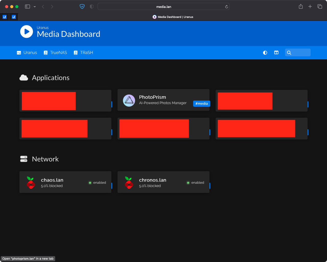

Yes, that's what I have now, except I don't use subdomains (e.g. pihole.home.lan) because Pihole does not like it. I use 3 Raspberry Pi, 2 for Pihole redundant DNS and 1 to redirect all traffic to each Scale application through my home network, but you can use Traefik on Scale for that also. I personally don't like that approach because if Scale is down, my entire home network will be down, no DNS, etc. One important detail: you should never open your home network to outside world. Even if you register a domain and use Cloudflare, you expose your network to world and risk of being hacked. I use a VPN to access my local network from outside world.
I run @truecharts Homer app for media.lan front-page with easy access to all my Scale apps, Homer has support for each application API, showing you the errors, warnings, downloads etc. (uranus.lan is my Scale server):
Example of media.lan above screenshot and https://media.domain.com Cloudflare/LetsEncrypt example configuration, running on Pi with Nginx:

First server configuration is what I use now, second one is a "just in case I need it" configuration open to world, but I don't have that enabled. $auth_bypass is a mapped variable bypassing the local authentication, if local network is detected. In other words, I will be prompted with a Basic Authentication window, if I try to access media.domain.com from outside my local network. Still, that is not 100% safe, so I always use a VPN to access my local network from outside world.
