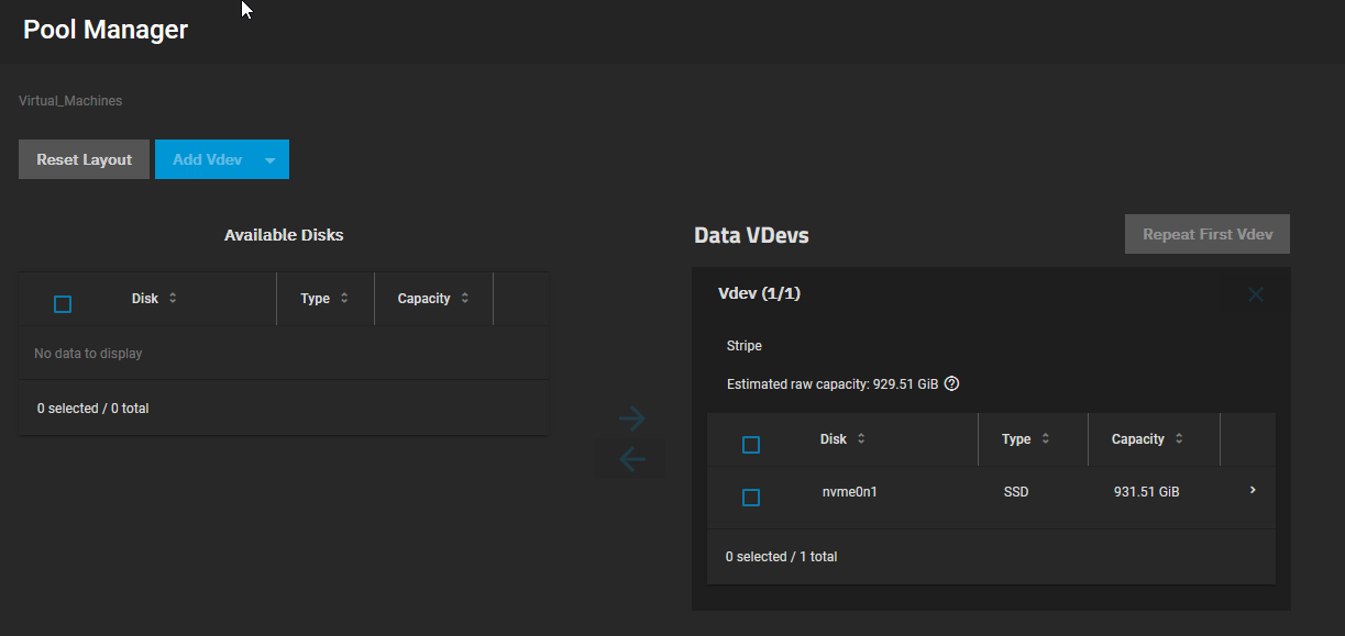

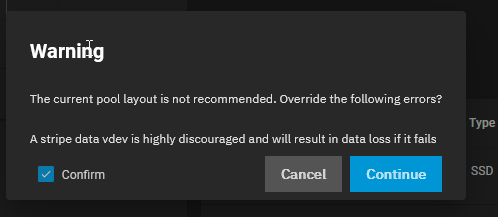

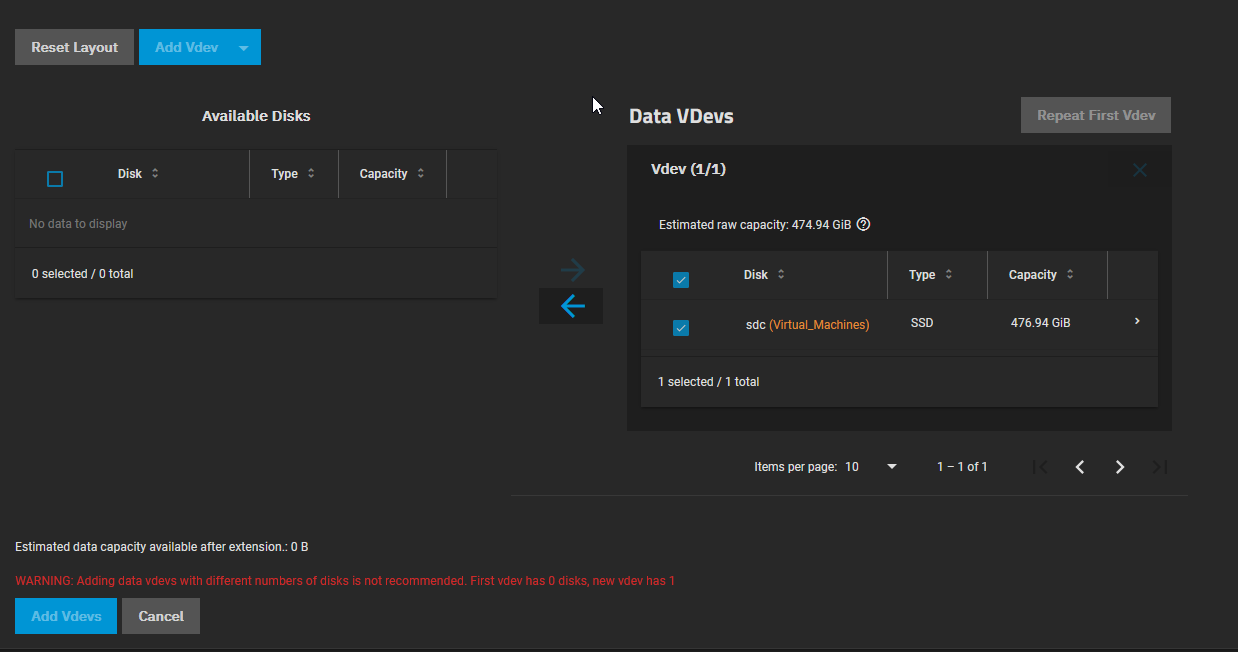

Before i do something wrong, is this the scenario, which should work?
Is that correct?
Patrick M. Hausen
Nov 25, 2013
7,776
DON'T ADD A VDEV!!!
Go to pool status, click on the menu to the right of the existing vdev, pick "extend". Sorry for the incorrect "expand" in my last post.
