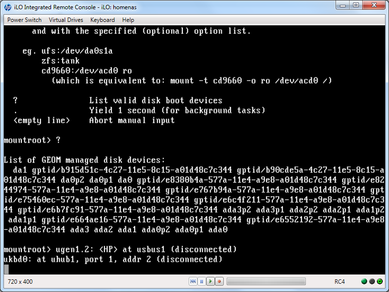

Long story short, I tried to restore a config saved on 9.2.1.8 on a 9.3.1 latest updates. It wouldn't boot.
Reinstall of 9.2.1.8 from ISO fails with error 19 about the GPT table of da0. 9.3.1 reinstall works just fine. The problem is that an import of the zpool does not restore all datasets on 9.3.1
How do I freacking reinstall 9.2.1 on my usb stick???
I have configs of both 9.2.1 and 9.3.1.
I tried wiping the stick with dd if=/dev/zero of=/dev/da0 bs=512 count=50
The root mount fails anyway.
Tried installing vanilla 9.3.1 and overwriting 9.2.1 and fails with error 19.
Is this some sort of freebsd retardness?

Regarding reinstalling 9.2.1.8, a 9.3 install writes GPT stuff to the disk that needs to be nuked before a non-GPT (eg 9.2) reinstall. Something like Active@ KillDisk should do the trick.

I blame USB3 for not being able to install 9.2.1.
Initial h/w config was 4X1TB mixed drives (1 Seagate, 1 WD Black, 2X WD green), HP Microserver Gen8 with 6Gb of ECC memory.
Now I have 16Gb of ECC memory, the same box and trying to access all the data from the above drives. I'll do the scub but the drives are fine and not much happened meanwhile they were not in use.
I did wiped the first 50 sectors with dd just to make sure.
gpart show da0
confirmed there's nothing there
