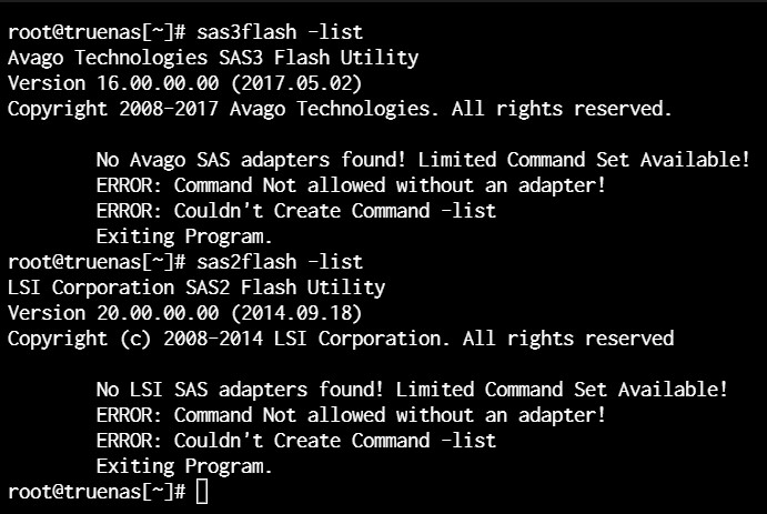

sas3flash -list on the command line will let you know...

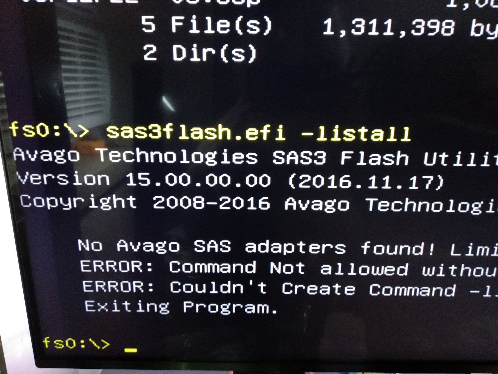

I reinstalled TrueNAS Scale bare metal, seems to be the easiest way to flash the HBA. I installed on a 120GB SSD connected to the onboard SATA controller, nothing is connected to the HBA. I can't see the HBA.
*Update: I can't see the HBA from the USB boot drive either.

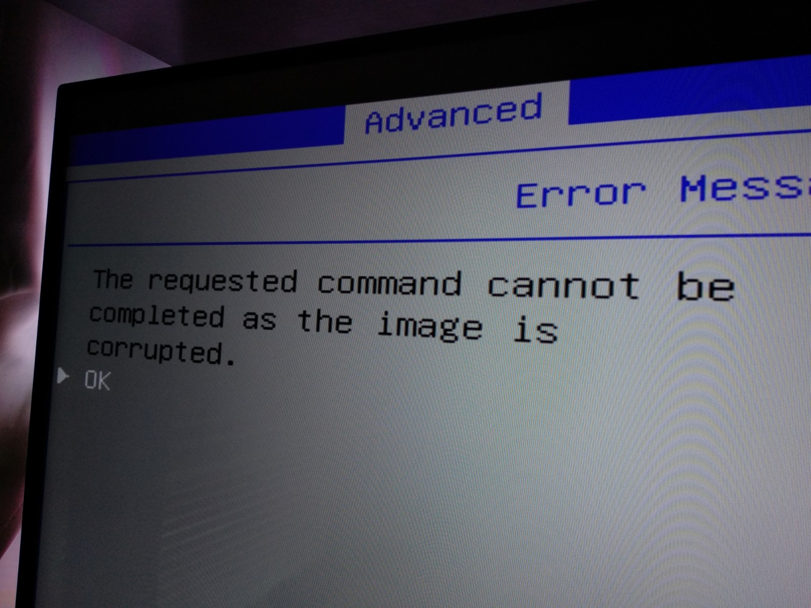

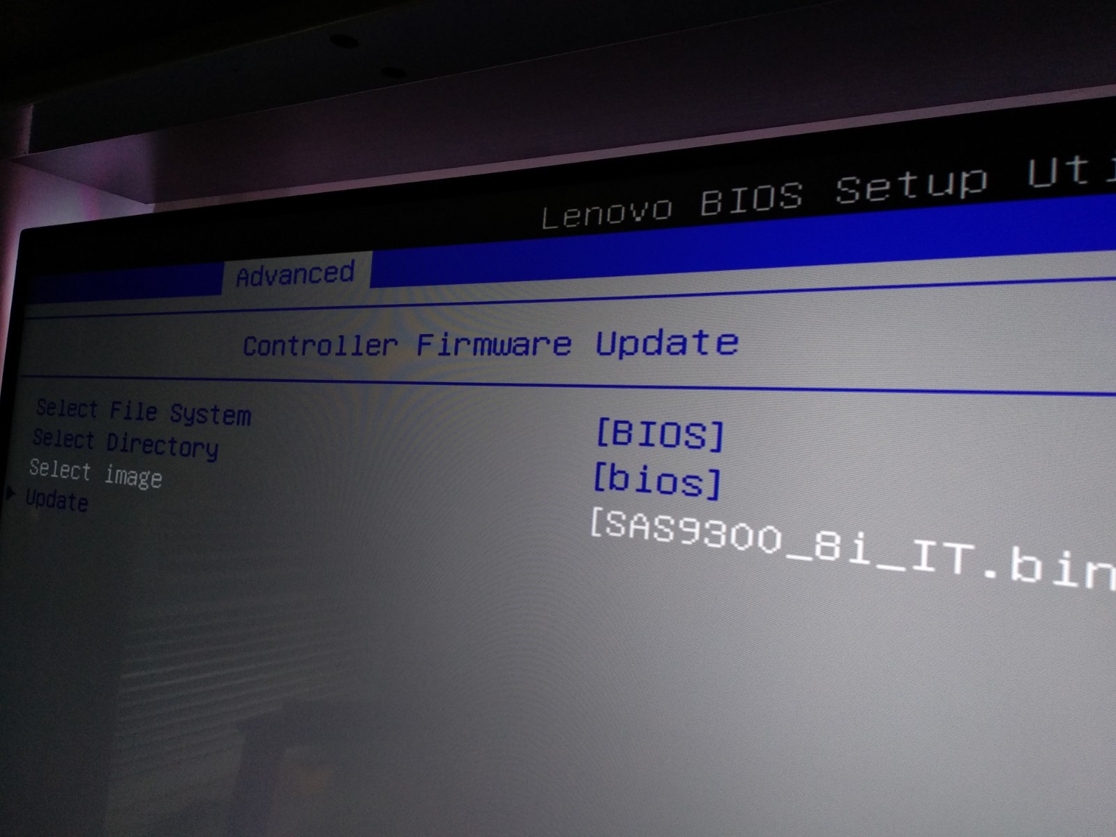

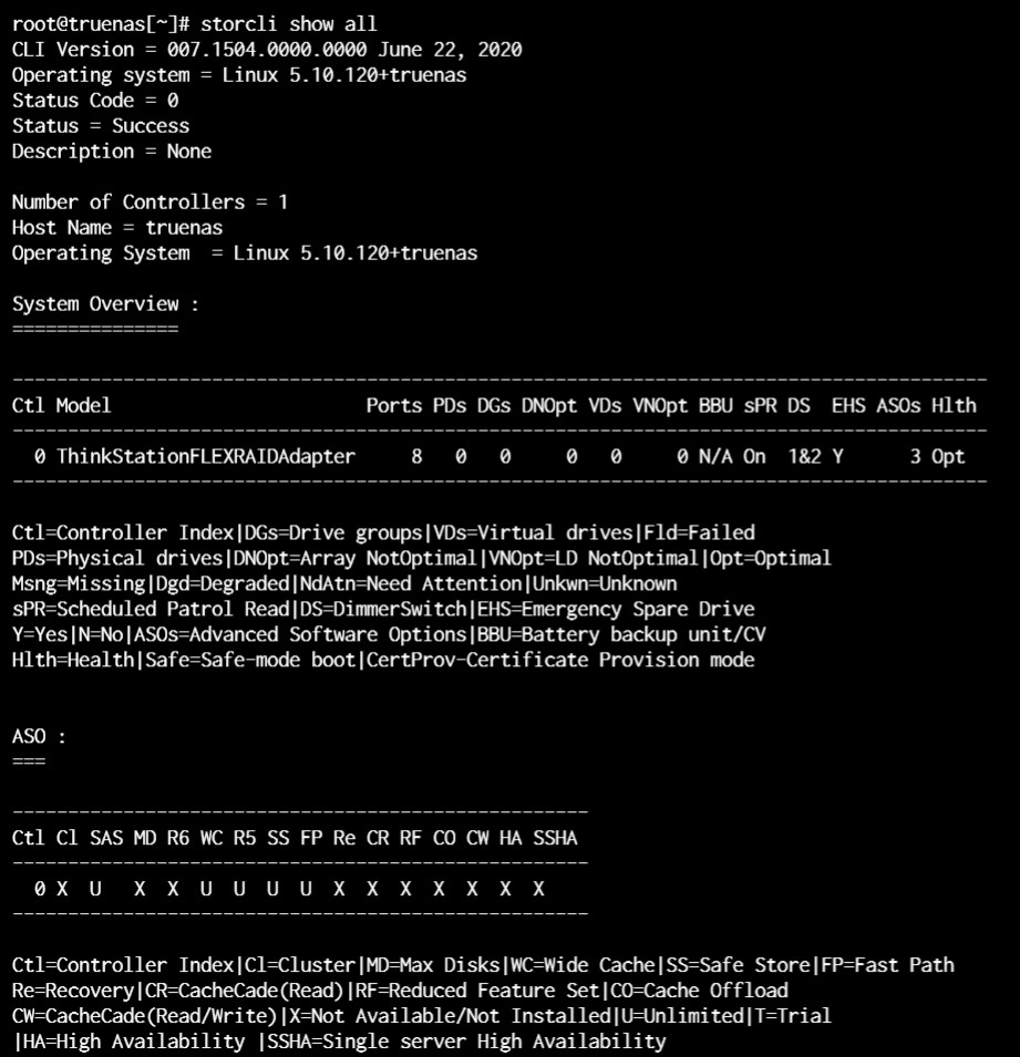

I have a proprietary card for older IBM/Lenovo Thinkstations, RAID flex(slot) adapter. It appears I have a SAS-MFI BIOS that requires storcli not sas3flash.
Proprietary isn't good for TrueNAS. Get a LSI 9207-based HBA - Dell H310 or IBM M1015

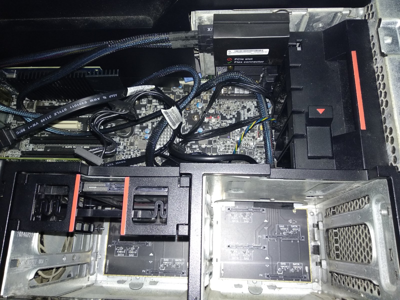

I'm going to have to agree, proprietary is no good. Seems I can't flash the card to IT mode. Is IR mode that bad? The card and cables are incorporated into my system, mobo removal was needed. I actually have 2 of these P700s with the same configs.

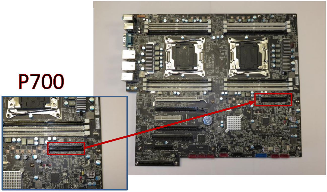

Can you recommend a external HBA suitable for my system? I am thinking of keeping the current card instead of using the onboard sata and passing through the external HBA.
diogen
Jul 21, 2022
72
By external you mean discrete? This one should be good enough...
The white slot in your third picture is a standard (old) PCI slot.
The black ones next to it are PCI-Express slots (what you need for the H310).
Based on this you have two PCI-E slots, x8 and x4, both open-ended (use the first).
Make sure you have the right bracket and cables to connect the HBA to the disks.
If the H310 is not flashed into IT mode (i.e. is not converted from PERC to HBA), use this writeup to do it.
Or get one that already is, this for example (it has cables and both brackets)...

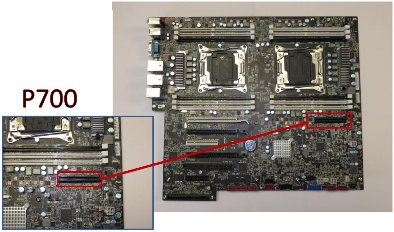

I stand corrected...
Based on this document only the x4 slot is PCIe v.2, the rest (five of them) are PCIe v.3.
And there are no regular PCI slots; some of them just happened to be white (see pic).
Hence, you might want to consider a H330 card like this and then you can reuse the cables that connect the drives to the flex card...

The PCI slot are divided by CPUs. The white are only usable when a 2nd CPU is installed.
I can't use the flex adapter and an HBA together. Currently the drives are connected to the flex cable backplanes. I need to remove those and flip the drives to connect to the HBA however my onboard SATA controller does support RAID.
I bought a couple of M5110/LSI 9207-8I HBAs (little concerned about the cables, ideally I think I want right angled). I also grabbed a couple of 5.25 HDD adapters because I only have 4 HDD bays.
