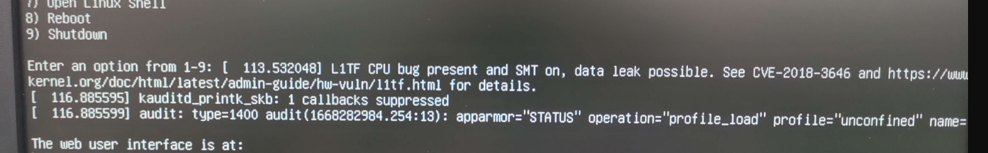

So i just made a new VM and tried installing BI without intalling the guest tools. (cpu host passthrough)
When i now start BI I do not only get a freeze but an actual BSOD "kernel security failure"
This also makes me think again of a warning i get when booting truenas: "L1TF cpu bug present and SMT on, data leak possible"
I searched for this on some fora and the general consensus i understood is that it could just be ignored.
When writing this it also brings me to another question: the above warning says SMT is on, but when i try to boot a VM with CPU model QEMU64 i get an error that the cpu does not provide the feature SVM?
I am just listing al weard thing i notice so that someone more knwoledgeable maybe can make somthing of this.
