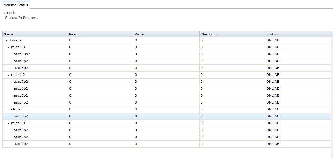

I have a 12 bay server I put freenas on. I think I just messed up expanding my storage. I currently have 8 drives now which are 2 sets of raidz1-0 and raidz1-2
I just added 3 more drives and extended my previous volume with the three drives I just purchased. I am thinking I messed up and should have waited till I bought the 4th drive.
Can I remove these three drives and re-do the extension ? I am assuming I can't extend my raidz1-3 listed below and add the 4th drive now ? I have a 11TB in use and not really wanting to remove everything to re-do it.
I am experimenting with using this as my media server. Did I screw up by adding the three drives and not wait till I have 4 ? Now I have one spare empty bay just sitting there. I assumed I could just add the last drive to the raidz1-3 listed below.
Thank you in advance for any feedback
 ~# zpool status Storage
  pool: Storage
 state: ONLINE
  scan: scrub repaired 0 in 11h40m with 0 errors on Sun Jan 27 11:40:56 2019
config:
        Storage                                         ONLINE       0     0     0
          raidz1-0                                      ONLINE       0     0     0
            gptid/5500d87b-37b0-11e7-81d6-00e081c95102  ONLINE       0     0     0
            gptid/400b5b6d-3755-11e7-81d6-00e081c95102  ONLINE       0     0     0
            gptid/439eeca7-3755-11e7-81d6-00e081c95102  ONLINE       0     0     0
          gptid/6c889a45-3a4e-11e7-8bf6-00e081c95102    ONLINE       0     0     0
          raidz1-2                                      ONLINE       0     0     0
            gptid/7c725411-b37e-11e7-b7a2-00e081c95102  ONLINE       0     0     0
            gptid/80f51b84-b37e-11e7-b7a2-00e081c95102  ONLINE       0     0     0
            gptid/84a93aa9-b37e-11e7-b7a2-00e081c95102  ONLINE       0     0     0
            gptid/8838375e-b37e-11e7-b7a2-00e081c95102  ONLINE       0     0     0
          raidz1-3                                      ONLINE       0     0     0
            gptid/8db5cf0d-42b0-11e9-8072-00e081c95102  ONLINE       0     0     0
            gptid/915c2d0f-42b0-11e9-8072-00e081c95102  ONLINE       0     0     0
            gptid/94f8c8f5-42b0-11e9-8072-00e081c95102  ONLINE       0     0     0

Between the 3-drive RAIDZ1-0 and the 4-drive RAIDZ1-2, there's a single drive that seems to be on its own. I hope that's a formatting error and isn't indicative of a single-drive vdev.
But yes; you did, in a way, "screw up" - once a vdev has been created, you cannot add or remove drives from it.

That one drive raidz1-0 ,not sure why it's spaced like that.
The raidz1-3 , can i delete it then recreate or is that a no because all the storage is now stripping all it's data across the new drives ?
Oct 18, 2018
969
If I'm understanding correctly you're correct, you cannot delete the vdev once it is added to the pool. Depending on how much data you've added you could backup the data, rebuild the pools using the vdev configuration you'd like, and then restore from backup. Take a look at the Slideshow explaining VDev, zpool, ZIL and L2ARC, it contains a ton of useful information about storage setups.
I never noticed it before, when I would check volume status on the command line, I just thought it was a clitch for that one drive
guess not, never looked at volume status from the gui before...... hahaha, well you live and learn... opps
Yep, that one drive failing would cost you the pool. You absolutely need to migrate off and rebuild.

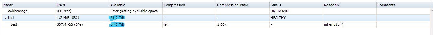

Does this look better everyone ?? One think I don't understand when you look at the screen shot. Why does it show a total of 21.tib then right below it shows 14.Tib of available space ?
I am going to take a guess why the size is off
Since I have total of 12 - 2 TB drives for a total of 24TB. and I have two raidz2 so 2 parity drives for raidz for a total of 8TB is that why the available space is 14TB ?

18TB is equivalent to ~16.2TiB. You'll loose a little extra to overhead.
Now, you could have created a wider, say 10 disk RAIDz2 vdev (I I wouldn't do 12) and you'd lose less (percentage wize to parity). But, with your 12 bay chassis and your inventory of disk sizes, having 6 disk vdev's allows you to grow you storage by upgrading 6 disks at a time. And, you're part way there with 4-x3TB drives.
AHHHHHH that makes sense ! I didn't understand why everyone keeps referrencing I should do 2 vdevs of 6 disk each........ its for the upgrade path of once one of the vdevs are all the same size, I will get the benefit of the size increase ?
ok, that is starting to make sense now.
