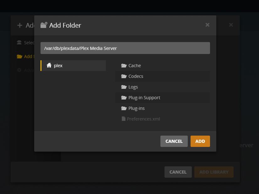

After the FreeNAS 10 disaster and recovery I have finally got back to installing the Plex plug-in. The problem I am having is when I add the volume with my media to the jail. I then start the Plex plug-in and I cannot find the Media share...Plex just doesn't see it for some reason.
So I can't add my media to Plex....the most basic of steps to get it working lol

You need to manually configure Plex to look at "/media", that means within plex it will not show /media as an option but you can manually type it in and then save your configuration. That should solve your issue. This issue happens a lot, I'm surprised a search didn't find this info for you.

Yes, this is the problem I am having. I cannot find /media. How do I add this manually to Plex?
You said type it in. So I figured typing /media/FreeNAS/Derek/Media/New Movies would work.....but no dice.
How do I browse the media share I want to add, without typing it manually?
You don't.
When you add a library to your Plex and when you click on "Browse for Media Folder", it opens up a browser. You need to manually type in "/media" (without the quotes) and save it. Now your media should be added.

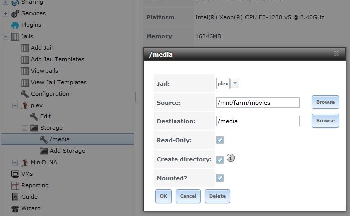

Hopefully you setup in the GUI the proper path to your media. Here is my example...

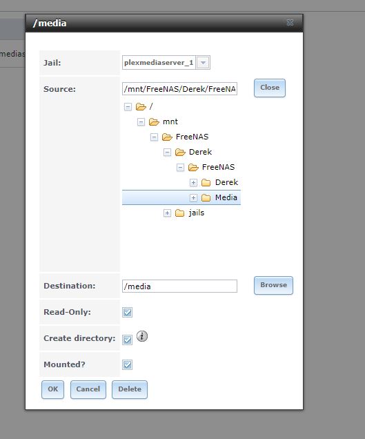

Right, but my media folder has many sub folders depending on the type of media I am adding....tv shows etc.
I have browsed my file system before....so how do I do that? Thank you but your "manual add" solution is not what I'm looking for.
The path to my media is setup correctly as per your example.

In the FreeNAS GUI you would link to the dataset location of "/mnt/FreeNAS/Derek/FreeNAS/Derek/Media" (by the way, that is one tuff path to follow) and in the plex jail you would link to "/media" (as you have done).
In Plex when adding a library you would manually enter any subdirectoy path beyond "/mnt/FreeNAS/Derek/FreeNAS/Derek/Media", and if I understood your path above you would next have "New Movies" so you would enter into plex "/media/New Movies" (include the quotes on this entry becasue you are using a space, I don't know if Plex will like it) for movies and and example for TV Shows may be "/media/TV_Shows" (no quotes).
Additionally, I would refrain from using spaces in directory paths, use an underscore instead, FreeBSD and Linux will like you better, otherwise you must use quotes around the entire path and hope Plex likes it.

Alright.....Thanks for your help! I seem to have it working and am able to find my subfolders! Very Much appreciated friend.
Good tip with the underscores. I'll be doing that moving forward
