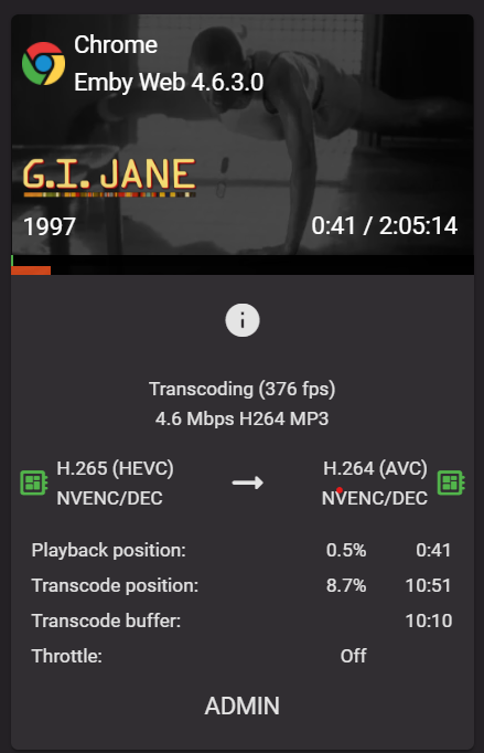

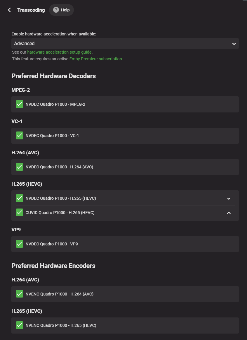

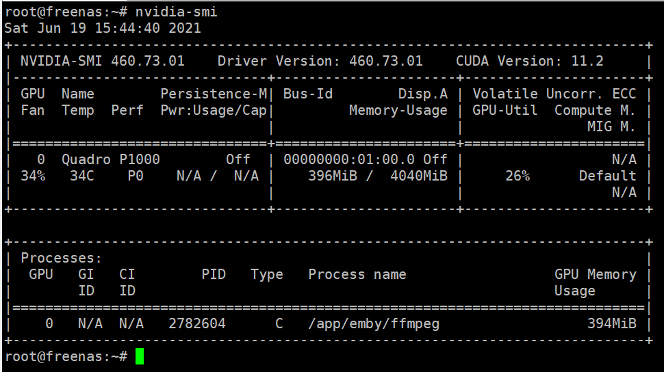

For what it's worth, I finally got this going on my end here using Emby and it was by staying within the lines and not circumventing the UI as previously I had to install additional packages via apt to get it working.
Almost all of my containers I created via "Launch Docker Image" from the Apps page and filled in the details. Emby sees the GPU for transcoding and nvidia-smi shows the Emby ffmpeg process when transcoding is going on.

I don't know if this will help but I noticed that you have 1 GPU in the system but for whatever reason it's not able to be allocated. I'm sorry I didn't notice in this thread how you spun up jellyfin but was it via launch docker image and you filled in the values or a official/truechart scale app? Did you exclude the GPU through the UI or otherwise as per the dev notes?
Here's mine, you can see capacity=1 and allocatable=1:
Capacity:
  cpu:                12
  ephemeral-storage:  945730304Ki
  hugepages-1Gi:      0
  hugepages-2Mi:      0
  memory:             65585196Ki
  nvidia.com/gpu:     1
  pods:               110
Allocatable:
  cpu:                12
  ephemeral-storage:  920006439010
  hugepages-1Gi:      0
  hugepages-2Mi:      0
  memory:             65585196Ki
  nvidia.com/gpu:     1
  pods:               110
Maybe this will help you, here's my config, adjust accordingly. I used "Launch Docker Image" from the Apps tab (see below.) I'm currently running host networking because of the port 9000+/kube requirement, etc but I did have it working in an isolate container as well before I used my current process of spinning up containers via the UI versus docker-compose:
AppName: emby
Image repo: linuxserver/emby
Update Strat: create new/kill old
Image Tag: latest
Image Pull Policy: only if not present on host
Container CMD: <empty>
Conatainer Args: <empty>
Envvars:
- TZ=America/Edmonton
- NVIDIA_VISIBLE_DEVICES=all
- NVIDIA_DRIVER_CAPABILITIES=all
- PGID=911
- PUID=911
Host Network: enabled/checked*
External Interfaces: <empty>
DNS Policy: default policy
Nameservers: <empty>
Searches: <empty>
Port Forwarding: <empty>
Host Paths:
- /mnt/ZFSPOOL/docker-data/emby:/config
- etc
Volumes: <empty>
Privileged: disabled/unchecked
Resource Reserveration: Allocate 0 nvidia.com/gpu GPU (although I have a "1 nvidia.com/gpu GPU" as well.)
