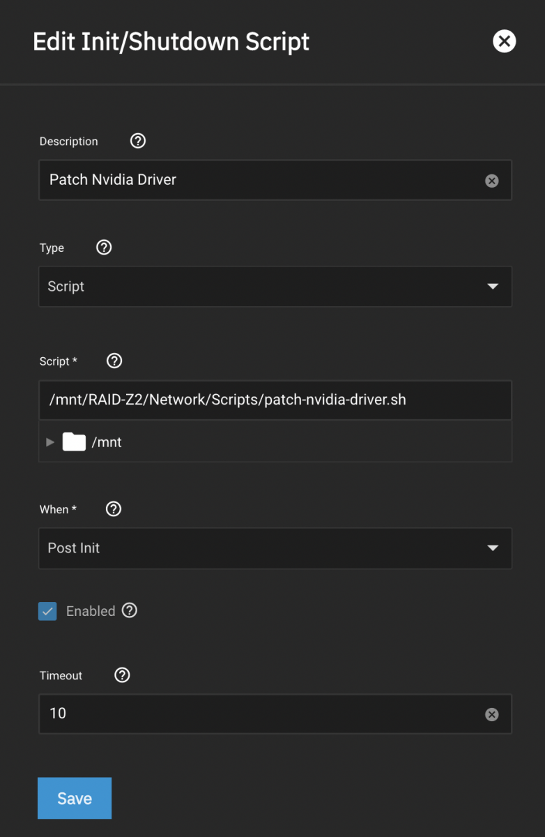

Just to add to this, as others have mentioned patching the host TrueNAS Scale OS's Nvidia driver did indeed propagate the patch to my plex app.
To do this, I created a post-init script like so
And pointed it to a bash script containing this code
