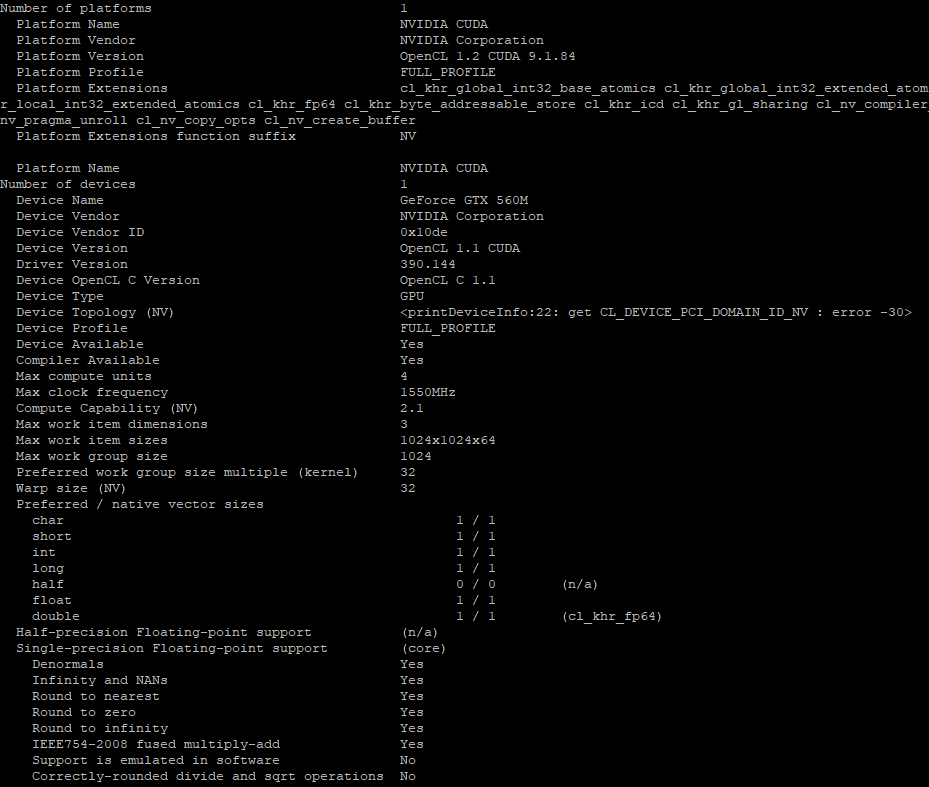

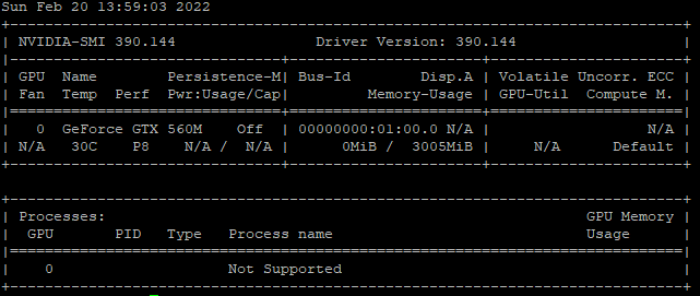

So after doing some digging I've decided not to submit a request. Here's why:
Installing, configuring and and getting apps to recognize the Nvidia legacy drivers & legacy opencl drivers is actually a piece of cake. The only thing to keep in mind is to not use apt to delete the pre installed drivers. Unfortunately though, even with all this "working", I slowly discovered that basically no software supports Fermi architecture anymore. What I mean by this is that the CUDA and opencl version included in the last working driver for my card is not supported by most software. This means that with this setup, it's theoretically possible to get some software working, but unlikely.
For anyone wondering about the process:
- apt install nvidia-detect
- nvidia-detect, this told me nvidia-legacy-390xx-driver. This is what the rest of the instructions are based off of.
- apt install nvidia-legacy-390xx-driver
- update-alternatives --config nvidia and select the legacy driver
- apt install nvidia-legacy-390xx-opencl-icd
- apt install clinfo
Everything should be set up on bare metal now, running clinfo and nvidia-smi should give something like:
So now to get the containers to see this:
- apt install nvidia-docker2
- systemctl restart docker
- Create an app and add 2 environment variables, NVIDIA_VISIBLE_DEVICES=all, NVIDIA_DRIVER_CAPABILITIES=compute,utility.
The app should now see the drivers, i can't remember if i also did this:
mkdir -p /etc/OpenCL/vendors && echo "libnvidia-opencl.so.1" > /etc/OpenCL/vendors/nvidia.icd
Since getting to this point i have killed the app, but it showed the proper info for both cuda and opencl, but did not recognize and usable gpus. The cuda version was 2.1 and opencl was 1.1, which from online resources, are pretty unfortunate versions.
I guess my main takeaway is that SCALE is surprisingly nice to you if you use it's Debian underbelly as long as you don't try to remove the packages that came with the initial install. Since they all installed at once, apt gets confused and thinks they are related.
Maybe i'll get some video transcode working in the future, but for now i'll leave it here. Hopefully someone builds off this or at least finds it useful and saves some time. :smile:
