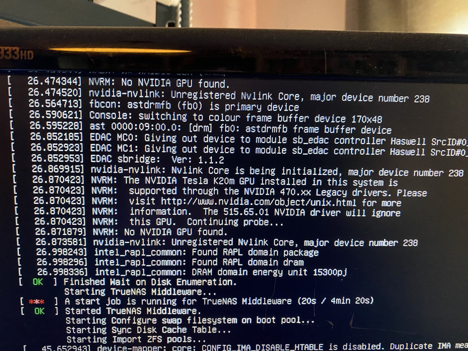

Now, I have found this (attachment) when I boot the system. Any ideas?
THANKS!

if you have not fix it this is because of a kernel version to driver issue your card is making call to the kernel it does not understand best solution is to run a vm with your selected OS and app. other wise upgrade your gpu. when they moved the kernel and driver to a newer version old legacy deivces are not understood between driver and kernel any more.
corilde
May 4, 2022
9
Hi! Thanks to both. In these weeks I did learn lot of truenas and yes, these GPU are not supported any more. For luck for me, in plex I don't need it and VM are detected it and I can use it.
