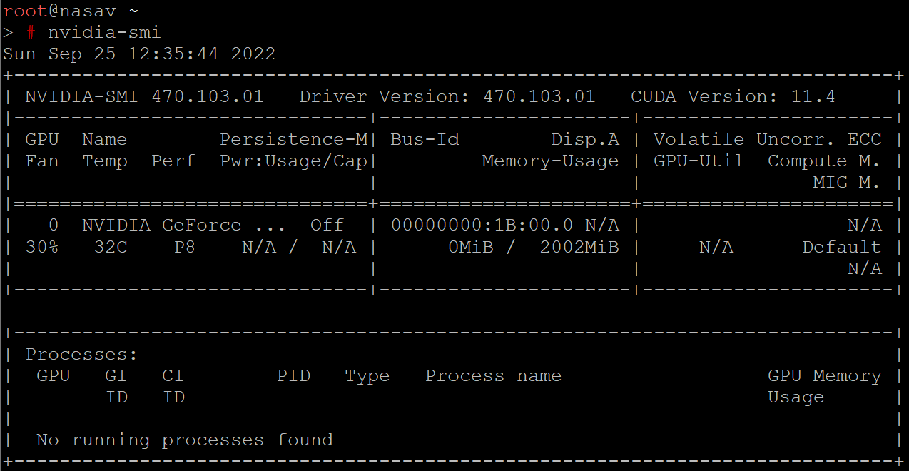

nvidia-smi output below would appear as though the GPU is recognized.

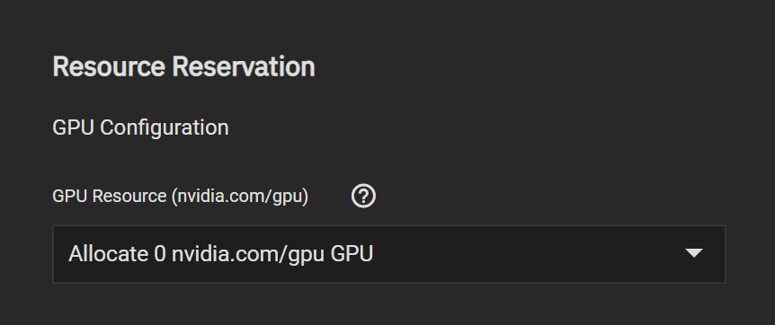

In Plex's App settings, I see the following:

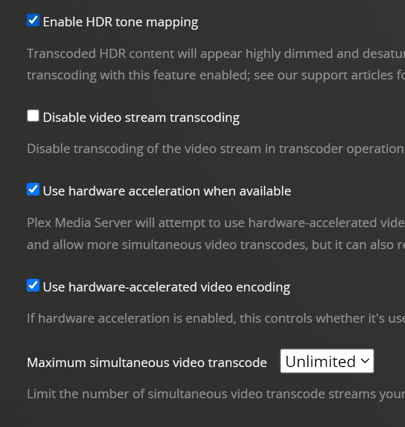

In Plex settings I have selected Hardware Transcoding
Whenever I run any video that requires transcoding, I see the CPU spike, and I run nvidia-smi a few times to monitor GPU temperature / memory usage and they always stay the same.
Any ideas on what I'm doing wrong? Thanks in advance!
In my instance of Scale the setting is 1 instead of 0...can you change it to 1?
I'm pretty sure that doesn't represent "number of GPUs" but rather which slot GPU can be passed through... I'm running Scale virtualized inside of ESXi - so if you're running on a dedicated machine, maybe 0 for you is the onboard GPU and 1 might be dedicated, in my case I only have the passthrough GPU from ESXi recognized as the GeForce.
Hmm I think this might be where you've gone astray. @duderuud was correct to suggest the GPU needs to be allocated (i.e. 1) in the Plex App settings. It's not related to the slot that is being passed through.
In the Plex App settings, I have allocated the GPU like so:
I think it does represent the number of GPUs to allocate as I have many apps with 0 and only plex with 1. I only have one GPU with no vGPU support in my system.
