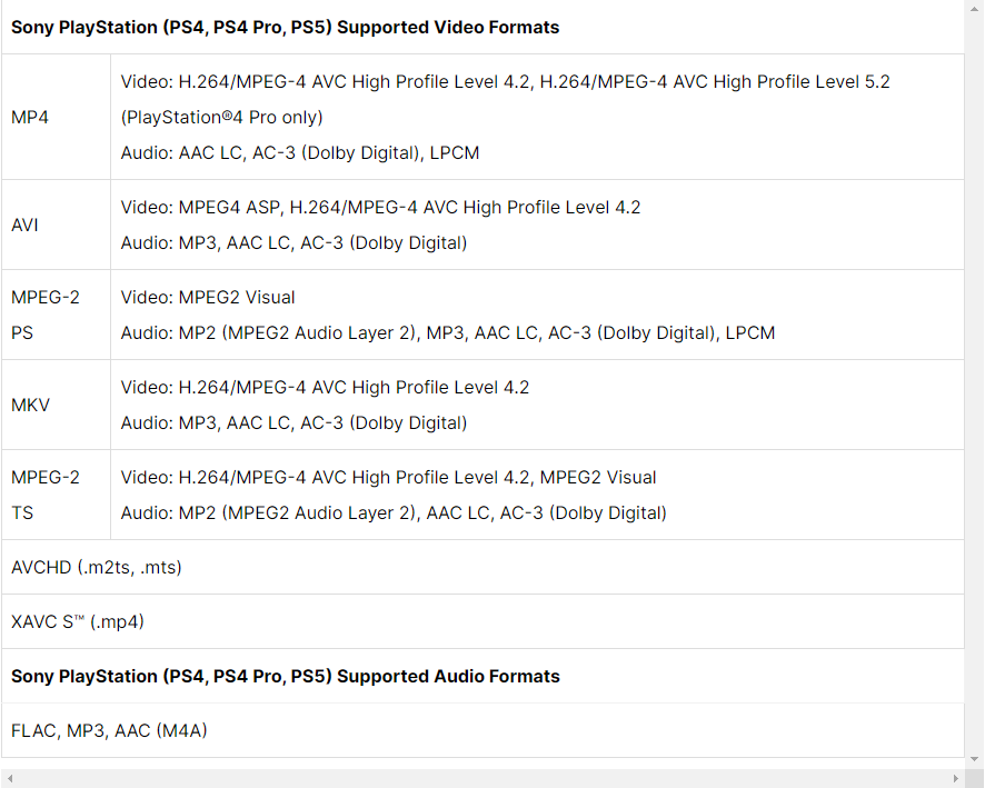

you have a few things that could make that happen and there is a lot here are some examples of supported types https://www.acrok.com/sony-playstation-supported-video-audio-formats/
if your encoded source is at a higher Profile level transcode will have to happen audio not of the same it will transcode there is a difference from direct play and direct stream. if the container is not of the supported type it will transcode. so i ask you do you know what the source media container format is and how the video is encoded to start then i can help with getting it direct stream/play. it might be two things either the player your PS5/APP on it or your source media are not supported install the plex app on your desktop and play it there. if it direct play/stream on that then you know an issue is source media or PS5 related. more info is need to go any further
