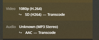

Ok how do I tell if the transcoding is being done by the GPU. I installed the Plex app
If you open up Plex dashboard and look at the active transcoding sessions, any stream that's using hardware transcoding will have '(hw)' in the stream details.

That's what I was afraid of. I am still only getting CPU transcoding. I attached the Plex settings do I have something set wrong here.

Ya 5 posts up I showed what I had for settings in Plex. I switched over to the Nightlies cause I heard that they had been working on getting the NVidia GPU integration for plex up and running fully but every time I test it, it only says transcode and and I see the CPU spike. I have tried deleting the Plex app a few times but no change. I'm doing all this testing on an old AMD FX chip and the motherboard is only a PCIE 2.0 board I'm not sure if that's my issue but I want to make sure I have everything working before I switch it over to my Threadripper TrueNAS Core machine.
