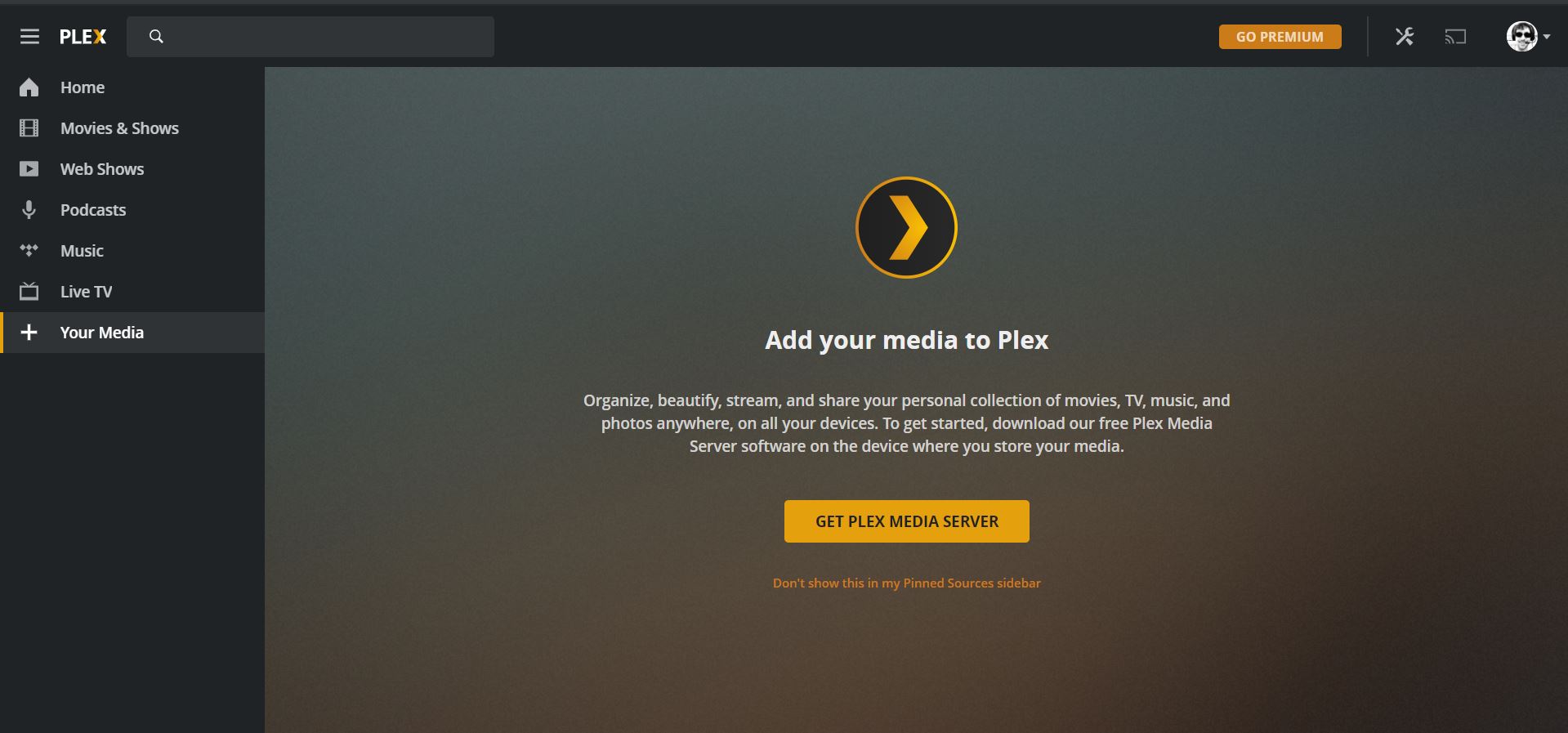

Hi All
So I have been researching for hours now on an issue I am having with my Plex Media Server install on my TrueNAS server Version: TrueNAS-12.0-U3 Plex Server: 12.2-RELEASE-p6 - Version: v1.22.3.4392
All I get when I go to my plex server or well I think I am going to my plex server is
I am going to it via the TrueNAS --> Plugins --> Manage tab
my installation is fresh
I am not sure if I need to make any changes or new user.
I have tried different things to get claim the server but without no success. I've also had the issue of no soup for you error too.
I have tired to go to the server via my phone but can't seem to find it via that way either.
I am stumped as to what is happening.
If people need logs please let me know and I will get the logs
Any help will be great thanks

Does remote access show that your plex is accessible outside your network?
What is the exact url you are using to access the server for the first time? I have run into issues myself when reinstalling / migrating to a new server where it does not take me to the "wizard" or the start page to complete the setup. Not sure if this is the same issue you are having (I don't run PLEX in a jail), but it sounds like it might be. Be sure the address is: http://ip.addr.of.host:32400/web

So I am using the manage button in TrueNAS to access Plex.
Threedee I’m pretty sure I have remote access off but it’s been awhile so I’ll check the settings.
I was using Plex before after TrueNAS crashed on me.
I have done all the normal mount points and everything via different tutorials and still get No Soup For You Error.

So did you have a Plex server before? If so, i assume you did you log in with your account details. I also assume that you defined the mount point(s) in the jail after installing the plugin, correct? So all you would need to do is to configure your directories within Plex, right?
Had Plex install before TrueNAS failed to boot one day then I left it cause I didn’t have time to fix it.
Only been in the last week I fixed it.
I’ve done all the mount points and everything for it plus tried different setups and still no soup for you error really frustrating cause I’ve had it running before

Try visiting (as counter-intuitive as it may seem) this URL. Enter it directly into the address bar in a new window or tab (or even a browser running in incognito mode):
https://app.plex.tv
From there, login with your email address and password (upper-right corner), and then enter your four-digit PIN (if you made one).
See if it then gives you access to your Plex server (which is hosted locally on your TrueNAS jail).

I’ve tried that no go it’s really strange

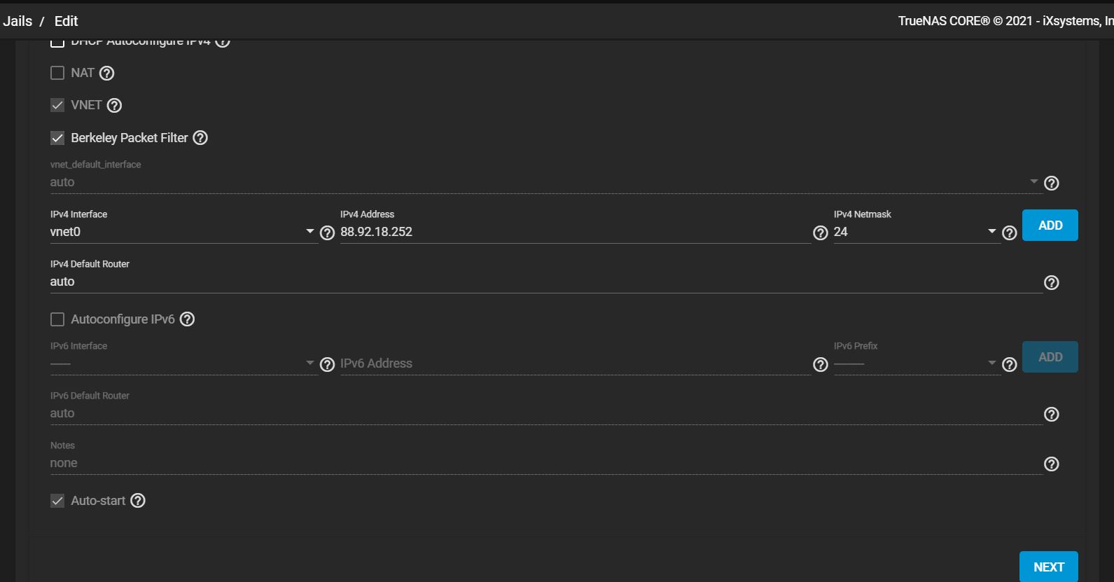

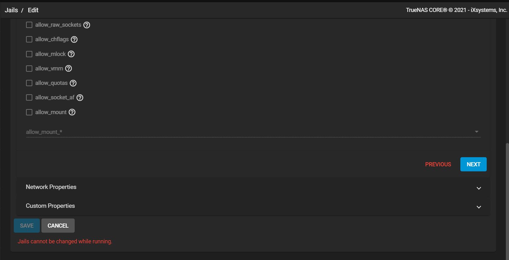

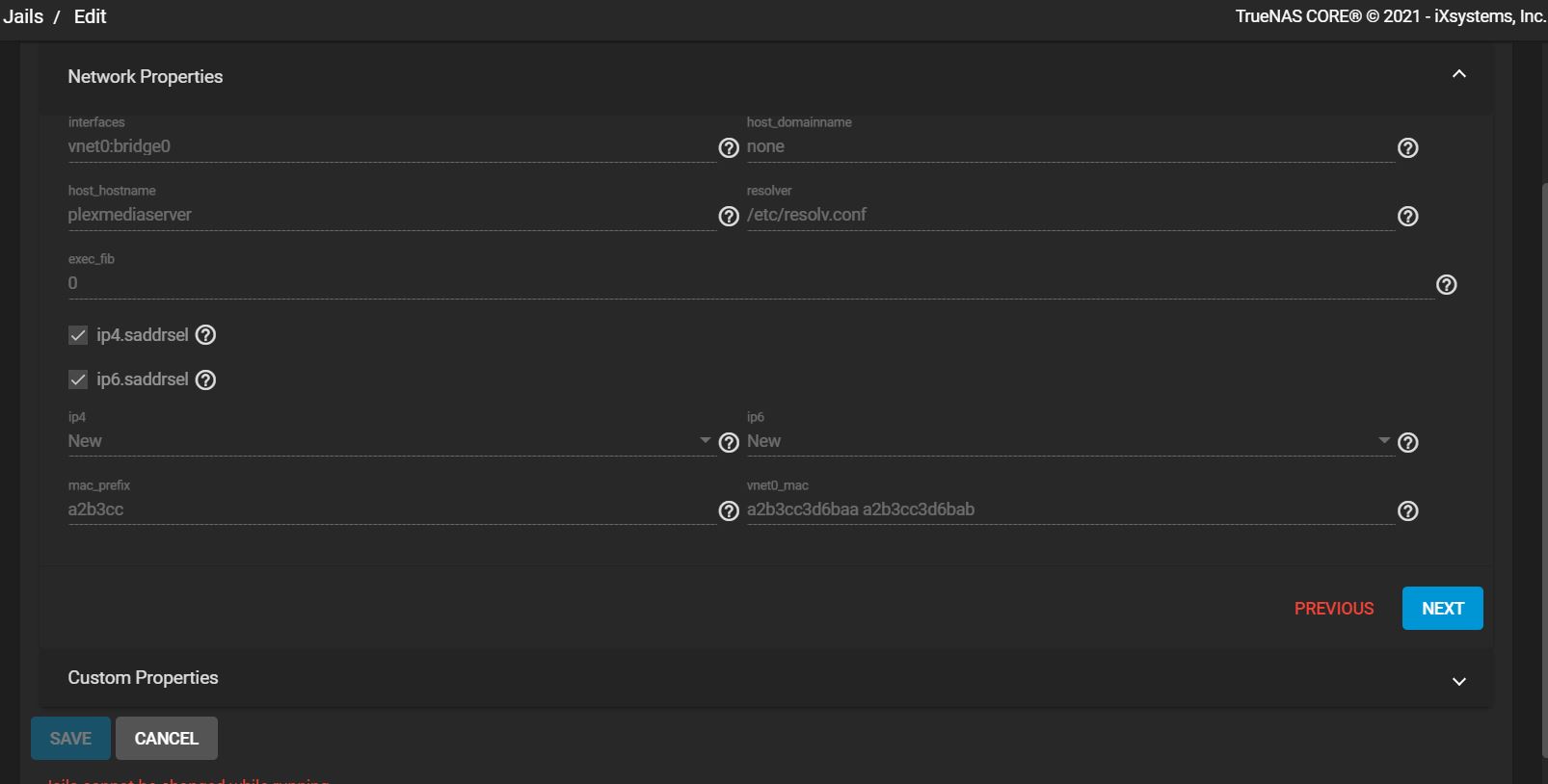

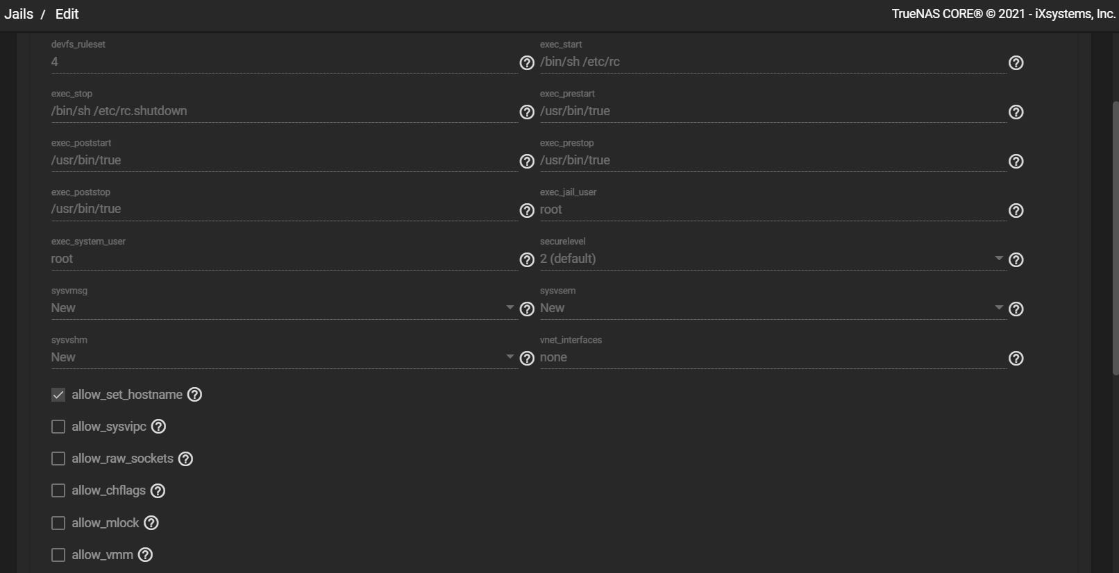

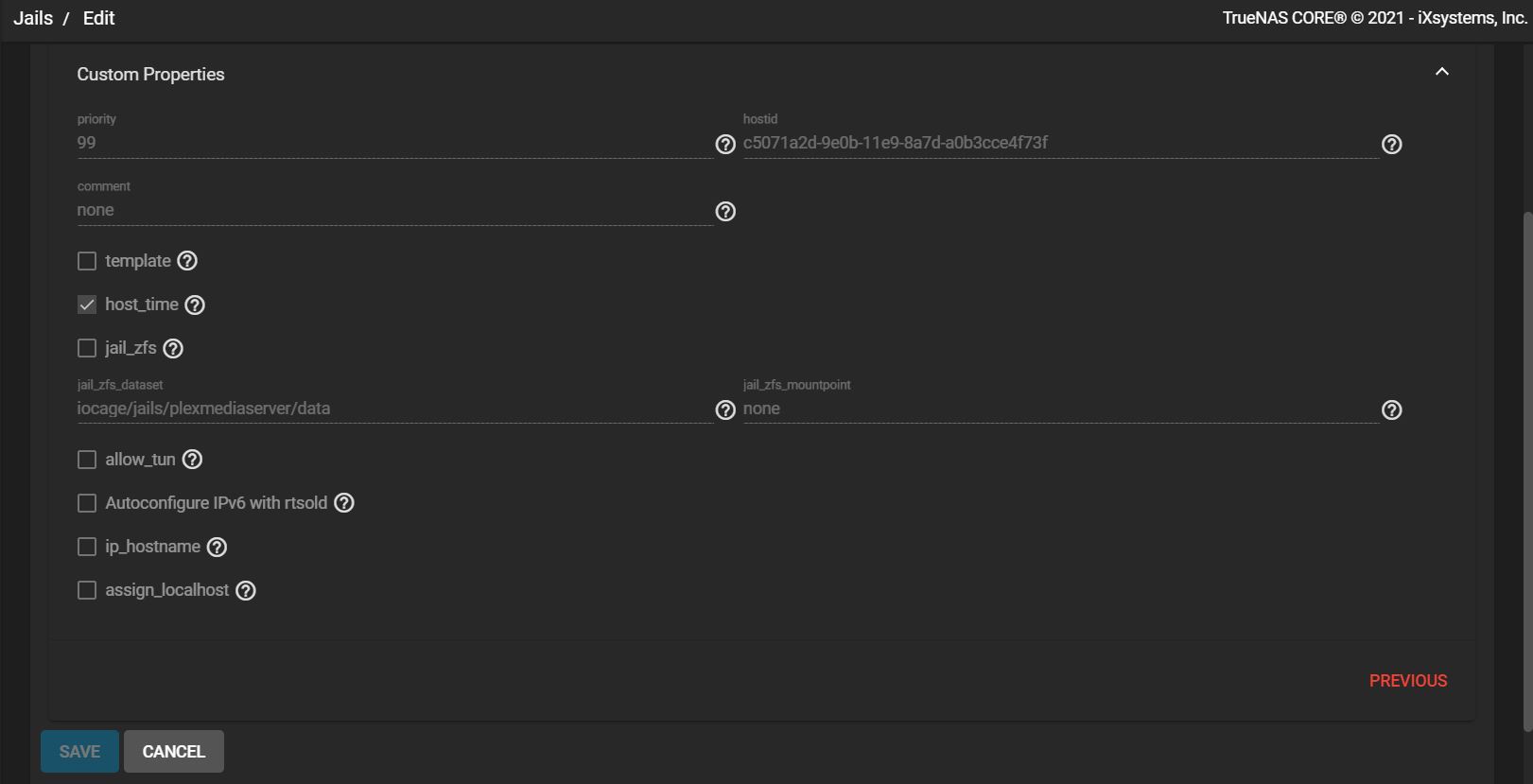

can you screen shot your jail configuration?

I’ll take a screenshot tonight.
what information do you need from the jail?

I’m not sure if my IP address might be the issue it’s 88.92.18.0 subnet 255.255.255.0
what boxes you have checked .. ip address, gateway . .vnet .. stuff, lol .. see if there might be something hinky in your jail config

Ok, will screenshot within the next couple of hours

stop your jail and put in gateway IP in IP4 Default Router instead of having it at "auto" and see if that helps
