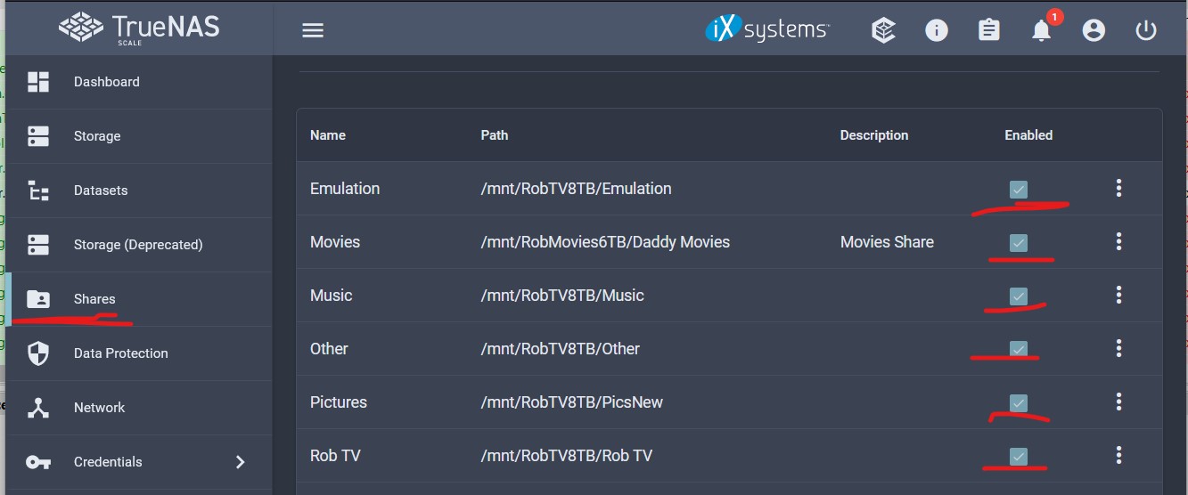

rs_taylor
Jan 28, 2013
53
I'm having same issue with Jellyfin being stuck "Deploying".
It seemed to have an issue with me using an SMB share with the same path as i was exposting in Jellyfin (bizarre right?).
Anyway i disabled all my SMB shares. Stopped JellyFin, Started JellyFin, once it became Active i reenabled the SMB shares.

@rs_taylor How did you disable the shares? I booted back to the most current update, stopped the Plex and Jellyfin app, turned of the SMB service slider, and then attempted to restart the apps. Still stuck at "deploying" with the "bad request 400" in the logs. Rebooted back to the 626 environment and all's well.
rs_taylor
Jan 28, 2013
53
Turning the SMB servicce off for me didn't help, i had to Disabled all the shares individually.
Then STOPPED the APP (if still stuck "Deploying") and then Start it again & it became "Active", then i re-enabled all the shares again.
I have to do this again each time i want to start Jellyfin (upgrade, server reboot etc)
rs_taylor
Jan 28, 2013
53
