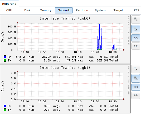

Here is a SS of the network on my freenas box. The first couple on the left are from the iPerf test. The transfer on the right is me uploading from my Mac on the network. The same computer I ran iPerf off of. I'm confused.

Your SS is showing 200 Mbit/s transfer speed, NOT 20 Mbit/s. Your numbers on the original post might be a little off. I'm going to assume you are on a Gigabit network and those are just typos. How are you doing the transfer? AFP, NFS, SSH??? The protocol you're using could greatly explain the speed you're seeing. Also, just to confirm, you're connected via a physical cable right? Not over WiFi?

I'm using a CIFS share to connect to from my Mac. I will try making a AFS share and see if that makes a difference. I'm assuming a Gigabit network should theoretically be 1000 Mbit/sec? Just weird that my test was 4X faster than the transfer from my Mac.

Yes, theoretically Gigabit should give you 1000Mbit/s, but realistically it can be anywhere between 300-900Mbits/s for a home setup. Reason is because there are simply too many layers of stuff in between. Disk read/writes eat up speed which is why people are going SSD. Does your Mac have a SSD or mechanical drive? If it's some kind of spinning disk, then that's where your speed went. Transfer protocols also eat up some speed (Read all of the posts about NFS slowness and you'll see) Samba shouldn't be too bad though even though it's still a single threaded process. I did a CIFS transfer between my desktop and my Avoton and I'm getting 800Mbps read/900Mbps write so the server has the horsepower to do it.
Iperf results are misleading. All transfers are done in memory so it doesn't touch any of the slower components. It's really meant for troubleshooting your network. Check your NIC speed again. Sometimes auto-negotiation can play havoc if you have an old cable or loose connection.

I use MACs at home.. I routinely see much better network performance using AFP compared to CIFS between all my devices, not just FreeNAS. I can get 900Mb/s writes to my FreeNAS box from a 1Gb/s connected iMAC. CIFS tops out around 500 Mb/s. Same network, same disks, same everything.
There have been reports that Apple's CIFS client is.. less efficient than the AFP client.
But, CIFS is the future in the walled garden, so we have that going for us.. :(

I did some testing last night. Created an AFS share on my freenas box. Speeds from my iMac were around 900 Mbit like they should be. I guess my iMac and CIFS shares don't play nice together.
