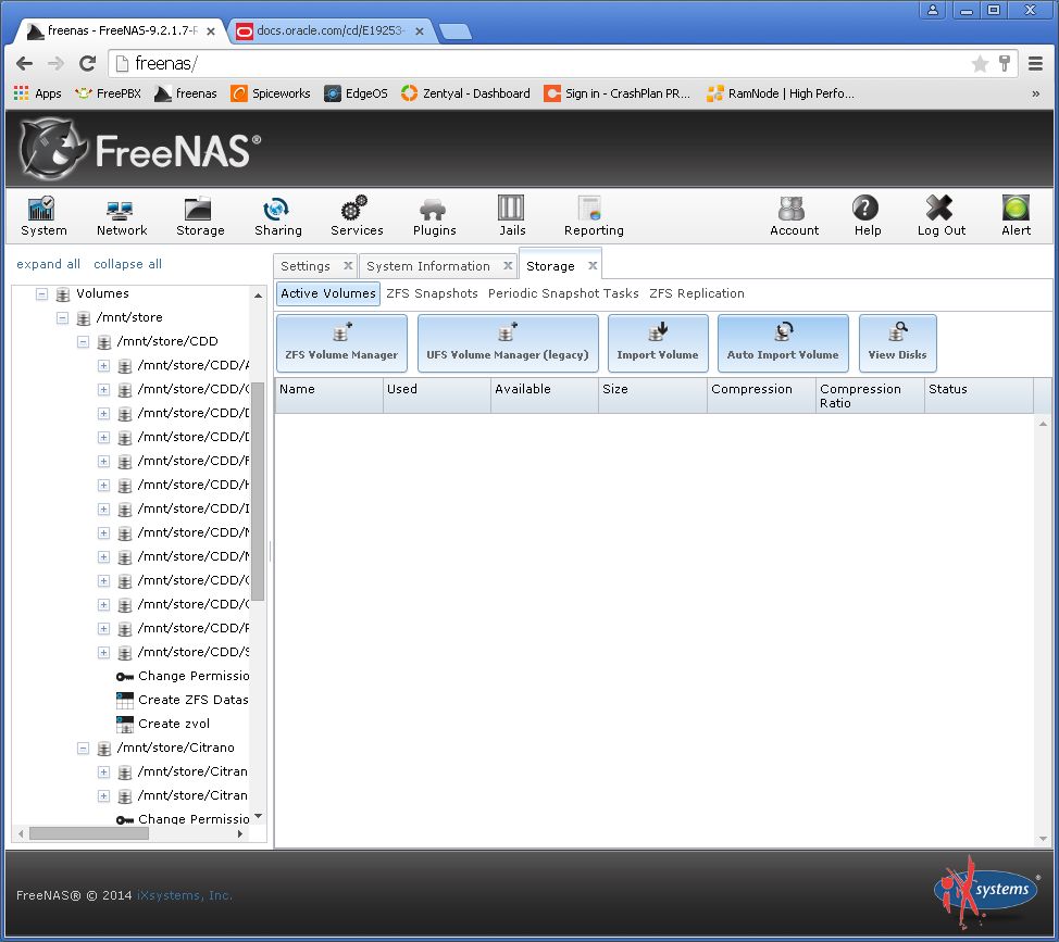

First, the FreeNas GUI shows NO VOLUMES OR DATASETS in the Active Volumes tab. HOWEVER, I can still browse the datasets and change settings in the left hand tree navigation! ALSO I MUST NOTE, THE DATA IS ALL STILL THERE. FROM THE CIFS SHARES AND THE CLI.

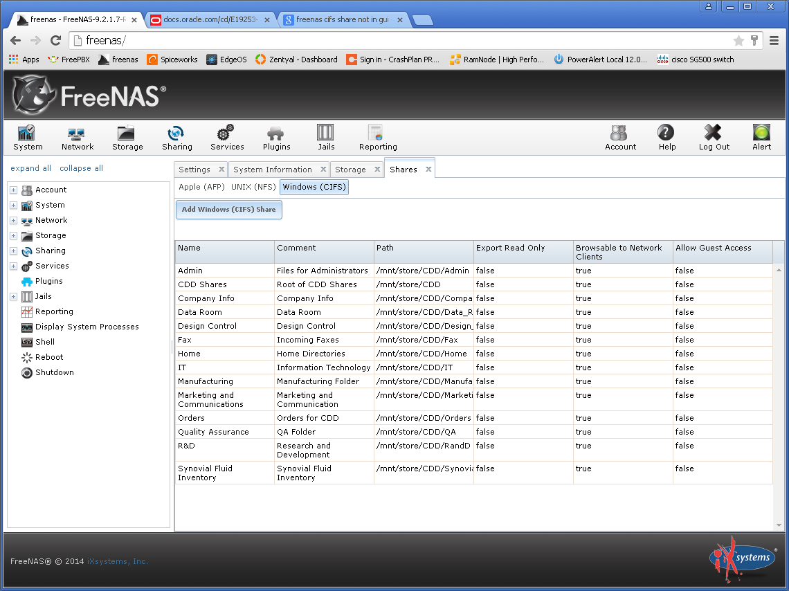

Second, the Read Only share that I created yesterday is GONE from the GUI, BUT I can still browse to it on the network! Looked at the smb4.conf file and the share wasn't listed in there either.

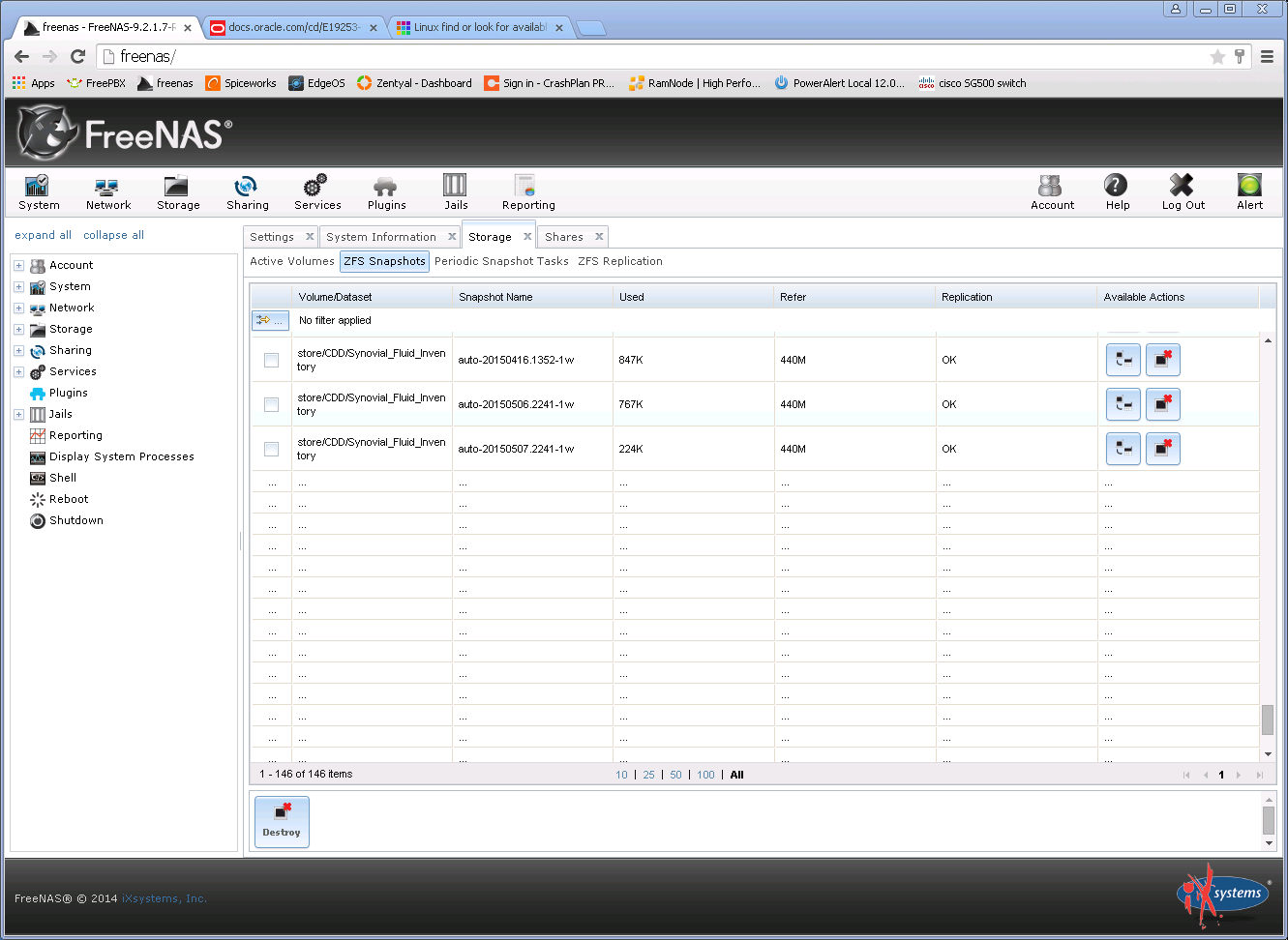

Third, something is not right in the snapshots section of the GUI either. It won't list certain snapshots that were replicated over to it, and if I try to filter to show them it returns an "sorry, error" message. You can see in the screenshot how there are snapshots at the end there that don't load (no matter how long you wait). If I check the snapshots at the CLI I can see them there!
