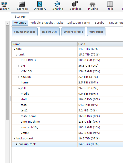

I'm at a loss figuring this out.
I'd like to replicate (either the pool or all it's datase's) to another FreeNAS machine as well as a different pool on the same server.
I got an error message when trying to configure replication of the same dataset to 2 different locations. So I created a snapshot and replication task at the pool level, so the individual datasets can replicate locally and the pool replicates to the other FreeNAS.
This sorta works, except the Pool only replicates the dataset structure, but not their contents. I've tried both without and with recursive snapshots and replication options. I can't get anything to work.
Is there any way to get data replicated to 2 locations?

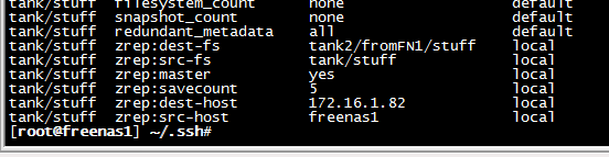

This is the second replication, (well third if you include Crashplan). FreeNas is replicating to another direct attached pool on the same server. I didn't use znapzend (co-developed by Tobias Oetiker). I went withZrep. Zrep is running zfs snapshots and sends/receive to a second local server, and so far I'm comfortable with the risk. I've read through the entire shell script (1000 lines). It's definitely something that I would love to get away from using, because it's another thing to keep track of (if I create a new dataset, I need to add the replication task separately in zrep). But it should do until FreeNAS10. The only thing I see it adding is some additional properties to the datasets:
