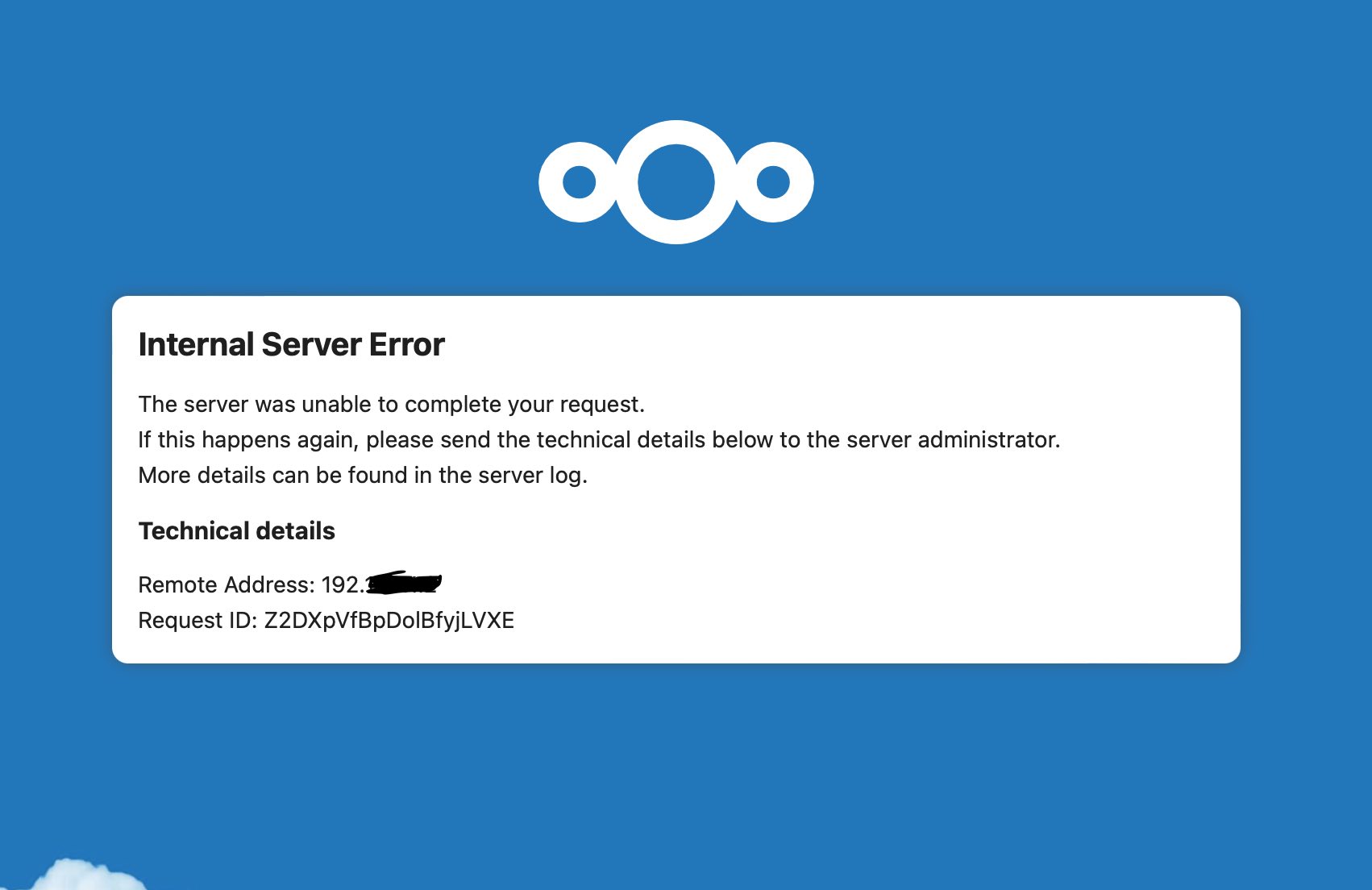

yesterday I tried to go to my nextcloud on the web browser and I got this
Internal Server Error
The server was unable to complete your request.
If this happens again, please send the technical details below to the server administrator.
More details can be found in the server log.
Technical details
  • Remote Address: 192.168.xxx.xxx
  • Request ID: AoCDkhJNAummxkY7PMIB
the nextcloud software works but I just can get in with the browers
I do not know what this means I get to the login page than after I login I get the internal server error
I am using freenes 11.2
and nextcloud 17
please help

Can you access it outside of your LAN?

I want to help, but if you used the plugin, it’s a lost battle. No one is maintaining it.
You are using an extremely outdated version of Nextcloud and also an outdated version of TrueNAS.
Please upgrade to TrueNAS 13 and I would highly recommend you just back up your nextcloud files and install using the script linked above.

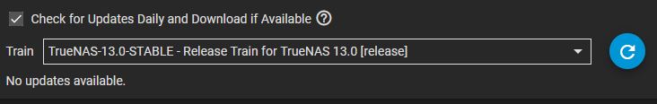

My TrueNAS Core is up to date according to TrueNAS i check for updates pretty much Monthy (or as notices pops up) and install as soon as our power situation in the country allows a long enough block to ensure a update has enough time with power to finish i just checked again and TrueNAS says it's up to date (See attached screenshots) I am not upgrading to SCALE yet as one or two of the other plugins i'm using has some issues on SCALE and time lines show should be sorted later this year or early next year.
I've also updated NextCloud according to the same rules above as soon as i get a notice update is available and power allows i update or i manually check roughly ones a month for updates.
Thanks I'll read through the link above and see what it requires.
By backup nextcloud files do you mean the photos etc cause they are one a separate dataset so even if my next cloud install totally dies i still have those, or are you referring to the next cloud user setups and database cause i'm struggling to find a "Non pro" guide on how to backup those any links for backing up the nextcloud db so i can just carry one where the files last synced after i do a new install?
Thats fine.
This is also fine, but you shouldn't use plugins anyway.
I mean all your user files. This doesn't mean the database.
Are you the only user?
If not, how many users do you have?
If photos are your only files then you could just install Nextcloud using the script, then simply mount your dataset containing your photos.
