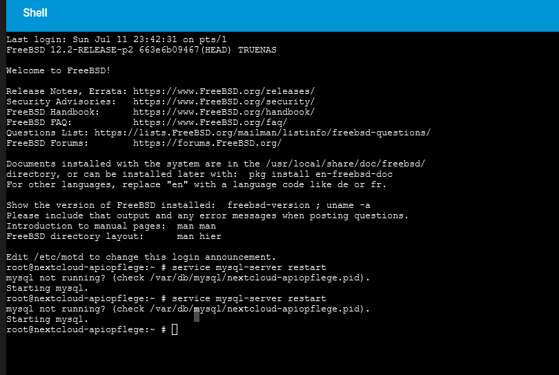

Probably your MySQL or MariaDB database is not running. Look in /var/db/mysql for a file ending in .err
Leonard Lassen
Nov 19, 2020
82
Hi, I found the file, here is an excerpt of the file.
2021-07-11T16:47:18.6NZ mysqld_safe mysqld from pid file /var/db/mysql/nextcloud-apiopflege.pid ended
2021-07-11T18:42:53.6NZ mysqld_safe Logging to '/var/db/mysql/nextcloud-apiopflege.err'.
2021-07-11T18:42:53.6NZ mysqld_safe Starting mysqld daemon with databases from /var/db/mysql

2021-07-11T18:42:55.224621Z 0 [ERROR] [MY-000067] [Server] unknown variable 'query_cache_type=0'.
2021-07-11T18:42:55.225274Z 0 [ERROR] [MY-010119] [Server] Aborting

If I read it right, something was removed from the system and now we have the Issue?

In /usr/local/etc/my.cnf or /usr/local/etc/mysql/<something> you will find a line query_cache_type=0. Remove that.
Seems like you updated MySQL and the new version does not support that option, anymore. This is not a TrueNAS issue but to be expected for *every* update of central components of Nextcloud. Reading release notes, following the update procedure outlined.

okay I removed the line in /usr/local/etc/mysql/my.cnf
What now, its not running
service mysql-server restart, then look again in that .err file - until it starts.

In the screenshot you can see what I get if I restart the Service. I couldnt find the File nextcloud-apiopflege.pid in /var/db/mysql/nextcloud-apiopflege.pid
This was in my .err file

2021-07-12T09:53:13.825446Z 0 [Warning] [MY-011068] [Server] The syntax 'expire-logs-days' is deprecated and will be removed in a future release. Please use binlog_expire_logs_seconds instead.
2021-07-12T09:53:13.825474Z 0 [Warning] [MY-011070] [Server] 'Disabling symbolic links using --skip-symbolic-links (or equivalent) is the default. Consider not using this option as it' is deprecated and will be removed in a future release.
2021-07-12T09:53:13.827127Z 0 [System] [MY-010116] [Server] /usr/local/libexec/mysqld (mysqld 8.0.25) starting as process 40799
2021-07-12T09:53:13.867371Z 1 [System] [MY-013576] [InnoDB] InnoDB initialization has started.
2021-07-12T09:53:15.014501Z 1 [System] [MY-013577] [InnoDB] InnoDB initialization has ended.
2021-07-12T09:53:15.182082Z 0 [System] [MY-011323] [Server] X Plugin ready for connections. Bind-address: '::' port: 33060, socket: /tmp/mysqlx.sock
2021-07-12T09:53:15.307738Z 0 [Warning] [MY-010068] [Server] CA certificate ca.pem is self signed.
2021-07-12T09:53:15.308001Z 0 [System] [MY-013602] [Server] Channel mysql_main configured to support TLS. Encrypted connections are now supported for this channel.
2021-07-12T09:53:15.318366Z 0 [ERROR] [MY-000067] [Server] unknown variable 'query_cache_size=0'.
2021-07-12T09:53:15.318979Z 0 [ERROR] [MY-010119] [Server] Aborting
2021-07-12T09:53:16.329976Z 0 [System] [MY-010910] [Server] /usr/local/libexec/mysqld: Shutdown complete (mysqld 8.0.25)  Source distribution.
2021-07-12T09:53:16.6NZ mysqld_safe mysqld from pid file /var/db/mysql/nextcloud-apiopflege.pid ended
Best regards Leonard
Patrick M. Hausen
Nov 25, 2013
7,776
The pid file is only supposed to exist while the server is running.
You still have the invalid setting in some config file:
You need to read the .err file and eliminate one error at a time until it starts. You can google for the individual error messages if you are unsure if statements need to be removed or changed.
