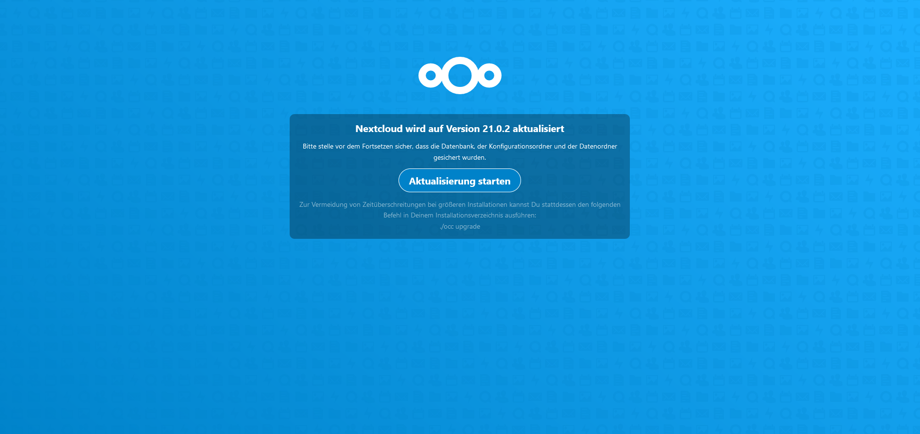

Okay cool, now the site is online.
should I click now on "Aktualisierung starten or shut I do something else?
Patrick M. Hausen
Nov 25, 2013
7,776
I'd recommend doing it on the command line. The web UI might time out and leave you with a half-done upgrade.
su -m www -c '/usr/local/bin/php /usr/local/www/nextcloud/occ upgrade'

Okay, I think we had this command a long time ago :)
Yes Now It worked :) Thank you!
should I do every update with su -m www -c '/usr/local/bin/php /usr/local/www/nextcloud/occ upgrade' ?
Best regards Leonard
Patrick M. Hausen
Nov 25, 2013
7,776
As per the Nextcloud documentation: yes, of course. :tongue:

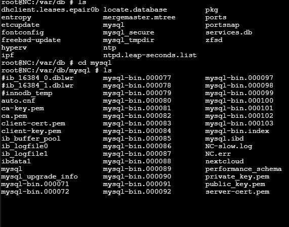

Probably your MySQL or MariaDB database is not running. Look in /var/db/mysql for a file ending in .err

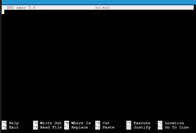

When i do this i get the following (opened NC.err with "nano" pkg)
I have the same "Internal Server Error" issue to the OP, and was following along (well reading) until i found this part, thought id have a look, and nada.
My Rig details etc attached
Img 1 - Files in /var/db/mysql
Img 2 - My NC.err file/log

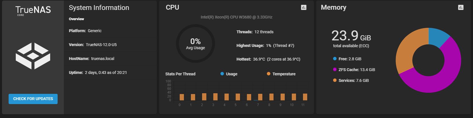

Img 3 - Rig Info

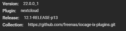

Img 4 - NC plugin info (Installed via IXSytems plugin part)

Patrick M. Hausen
Nov 25, 2013
7,776
What does service mysql-server status inside the jail say? What does cat NC.err show you? And please post these things as text in CODE tags, not as screenshots. Thanks.

So, repeating what I wrote about half a dozen times before ... here's your first clue:
2021-08-16T19:07:31.242247Z 0 [ERROR] [MY-000067] [Server] unknown variable 'query_cache_type=0'.
2021-08-16T19:07:31.242791Z 0 [ERROR] [MY-010119] [Server] Aborting
That means the parameter query_cache_type was removed from MySQL 8, but is still present in your config file. So please edit the file /usr/local/mysql/my.cnf and remove the matching line. Then try to restart your database server with service mysql-server start and check again with service mysql-server status.
Probably it won't start up. But there will be more error messages of the same kind in the NC.err file. Look for similar problems and remove the corresponding lines from the config file. Rinse and repeat until it starts.
This is expected after every major MySQL upgrade, documented in the MySQL release notes, and in no way related to TrueNAS, FreeBSD or jails. You want to run Nextcloud? You are now a database server administrator. Congrats.
I really do not intend to be condescending, but this is frustrating. Nextcloud is not an "app" but a heck of a complex 3-tier web application ecosystem. As I wrote in another context, you were possibly not even aware that you were running a database server. There lies the problem. Not your fault.
HTH,
Patrick
