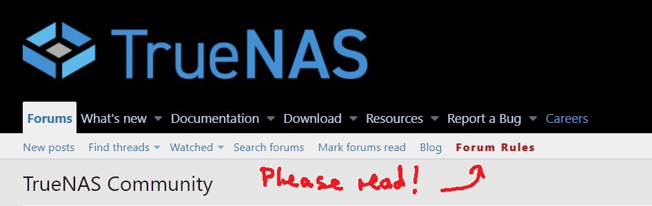

I am not sure what rule I have to read here. I am trying to decide if Truenas is a good platform for me. Nextcloud is a core application and it has 1000 variations and features being discussed in the NC forums. However, I am concerned about this particular NC-Jail which out of the box does not even work. Therefore I am asking Truenas experts if they have similar experience. NObody in Nextcloud Forums will be familiar with Truenas Jails.
Ohh, how much fun! :-D
"Please Search Before Posting"
That includes showing you googled your issue yourself and which solutions out there you already tried
"Posting To Get A Response"
That includes explaining your setup and adding logs when you encounter errors
"Inline Code and Code Tags"
This includes using tags around the error you posted, as your post is super hard to read now
"Solicitation of Support"
This gets pretty close to "I request someone to fix this", which would mean you need to file a Jira ticket instead
