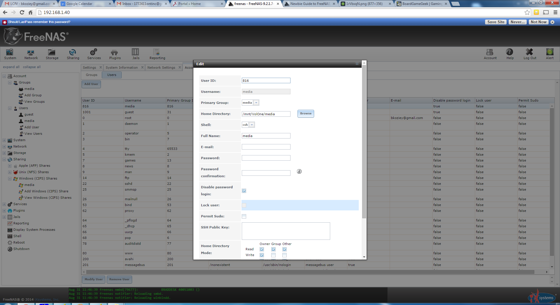

I've encountered a problem adding the media and guest user. I set Write for Group and Other and click OK the dialog closes but if I go back the Write permissions have not been enabled??
I encounter exactly the same problem on 9.2.1.9 - I created 'media' and 'guest' users and can't edit their Home Directory Mode permissions. I tick the boxes and save the changes but when I return to check - they are all reset.

This is my setup on my Windows 8 machine. Make sure you have read the manual to double check things over as well.
