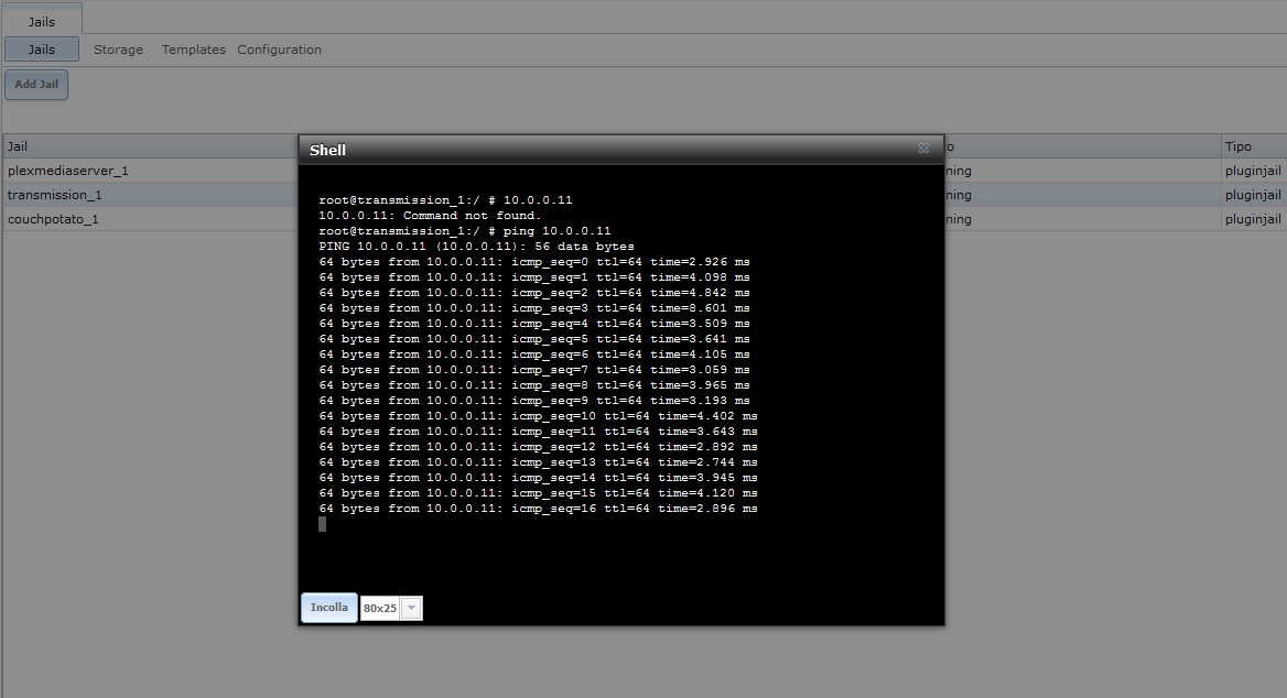

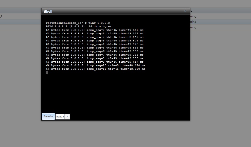

Hi Joshua
Actually now, after disabling VIMAGE, I think that Transmission Jail pings the IPs outside and inside my network correctly. But still, Transmission interface is not working from my iPad, whereas Couchpotato and Plex work fine :(
I attach the screens

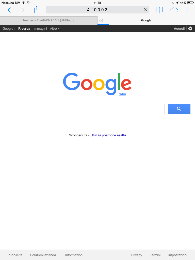

As I said, I don't know why. Can you show a screenshot including the URL of the failed transmission webui from the ipad
mbrunelli87
Sep 17, 2016
65
When I try to connect to 10.0.0.3:9091 (transmission's IP and port) it keeps trying to load the webui and then, after a 30-40 seconds, it says that it could not connect because the server is not responding. Same thing happens with my smartphone and laptop computer (only when using WIFI - if I connect it with the ethernet cable it works)
