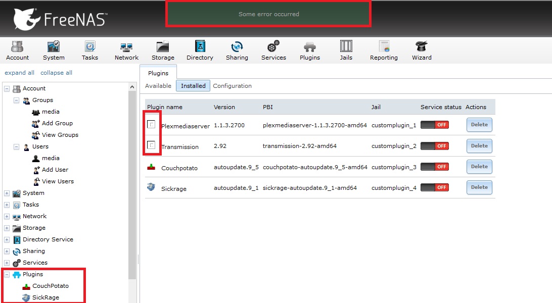

Everything went almost fine apart from the fact that when I uploaded a torrent on Transmission, the plugin gave me this error: "ERROR - Permission denied". So I went to the Jails dataset and set the permissions to "nobody" and "nogroup" and ticked all the checkbox of "Read, Write, Execute". After that, Transmission worked fine...till I rebooted the system.
After that, I went to the plugin dashboard to check if they were running, but their service status was "off", and it was impossible to set it to "on".
In fact, I tried several times, and every time I perform a clean installation and reboot, the system gives me the same issue.
Also, Transmission and Plex plugins are not even showed on the sidebar under the "Plugin" section and their icons are missing in the dashboard.
From the stuff I've read online, it seems It seems that I have a problem with permissions...
You can find attached the print screen with the error, please tell me if you need some more elements to understand what's going on, such as error logs, etc. (would be appreciated if you could also guide me explaining HOW getting the info you need from Freenas, since I am very new to the system)

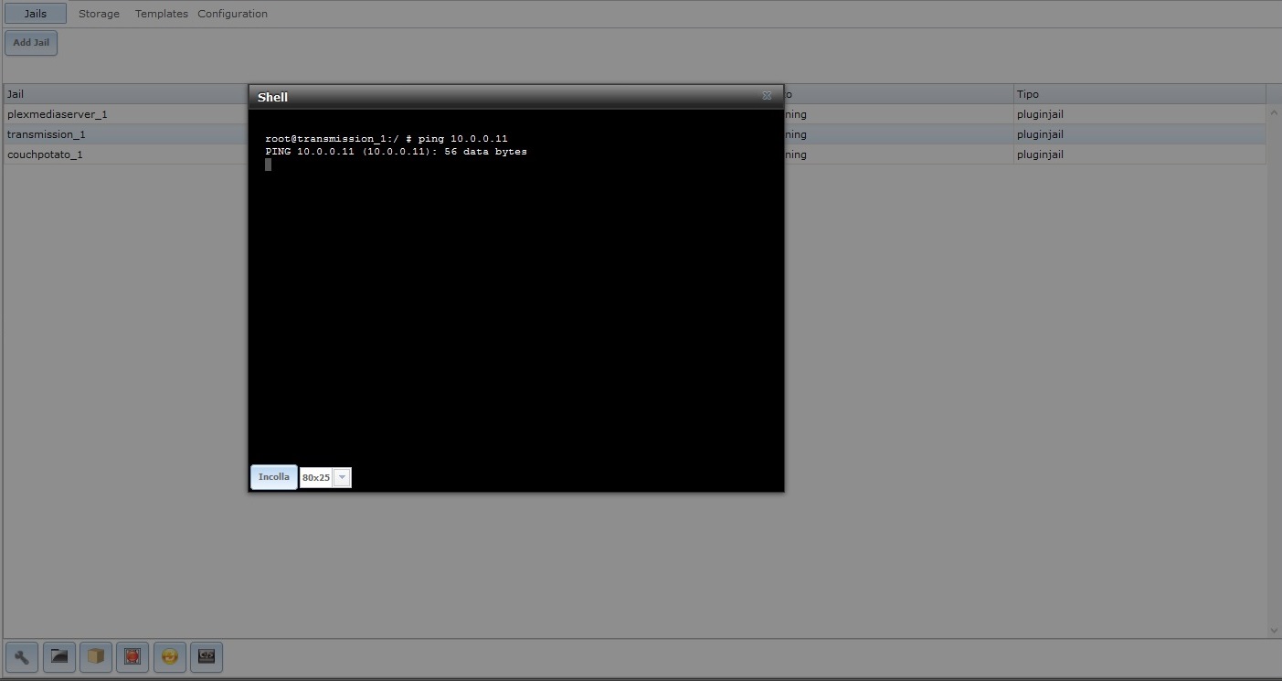

Can you ping the transmission jail IP from your wireless devices? Can you ping your wireless devices from your transmission jail?

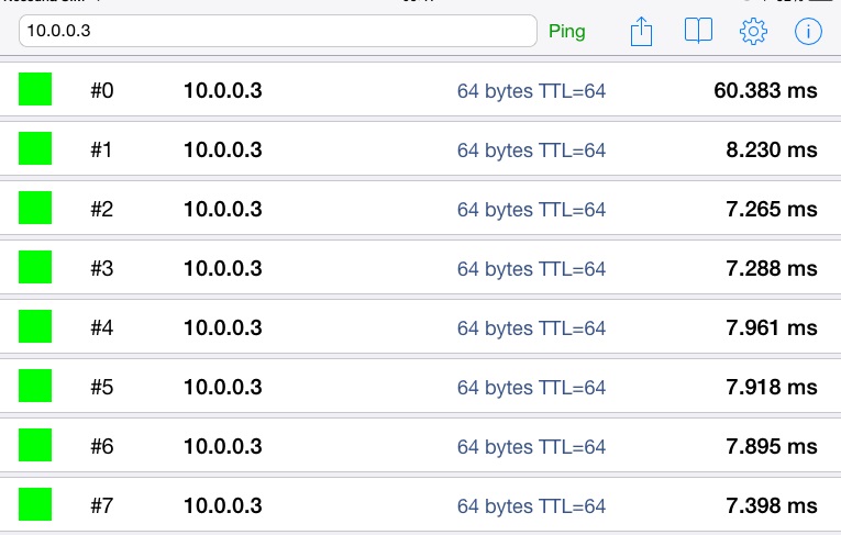

I tried to ping the iPad IP (10.0.0.11) from the Jail and the Jail IP (10.0.0.3) from the iPad, everything looks fine to me (see the screenshots attached)

That ping from the jail does NOT look fine. Your jail cannot route to your IPad's IP. I suggest you try disabling VIMAGE and assign a network interface for the transmission_1 jail, then restart that jail.
