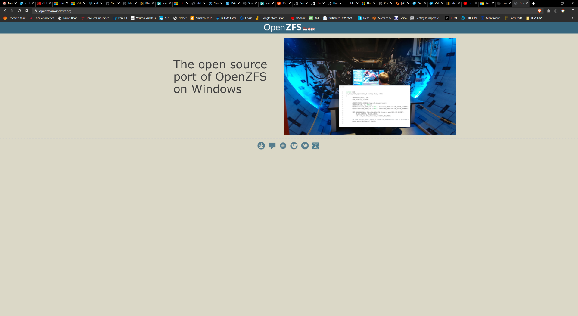

OpenZFS on Windows is over yonder. Note it's 0.23 and installation requires you to turn on the option to load unsigned drivers. I view this as a bit experimental, but maybe @Patrick M. Hausen has experience with running it.
Instructions for installing it and creating a pool at https://github.com/openzfsonwindows/ZFSin

OpenZFS is not an OS, it's an addition to Windows that lets you create ZFS pools directly in Windows. I am wondering why you want to go with a separate OS installation running inside a hypervisor at all? Create a mirror in Windows and share that from Windows. Or use OpenZFS in Windows and then share that ... no separate OS, no hypervisor, no hassle ...
Patrick
See that just goes to show how little I even know about this stuff. I've never heard of OpenZFS as an option in my research. It just wasn't a name that ever came up for whatever reason. And of course now I will be looking into it. My initial thoughts have me confused, as there's no website? OpenZFS.org is just a wiki page, and the link to the Windows version takes you to a website with nothing on it except a single fuzzy photo. Is this like a prank or something?
