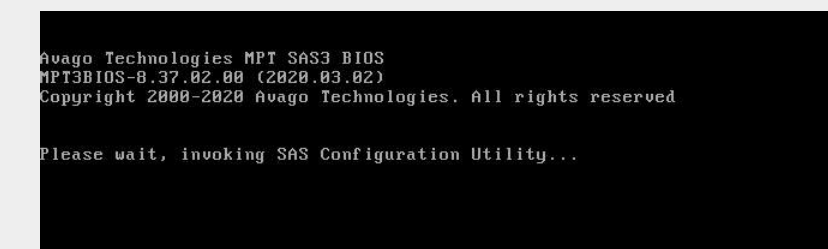

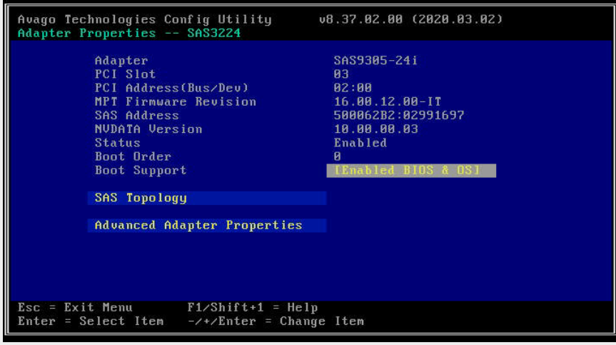

What firmware is on that HBA?
Is there a way to find this out within truenas or do i nees to press ctrl C on boot to go to the hba bios?

As for the HBA firmware, please note that I don't really keep up on this aspect of the forum as I do not use an LSI HBA, but I thought P20 vas the current version, not P16. Please do not take any action due to my comment, wait for someone who knows a lot more than I do on this topic give you advice. I can't say it this would be the problem for the UDMA_CRC_Errors either, I wouldn't think so but stranger things have happened.

P20 is for LSI 2008 (PCIe 2.0); P16 is for LSI 3008 (PCIe 3.0). Firmware is not the issue here.

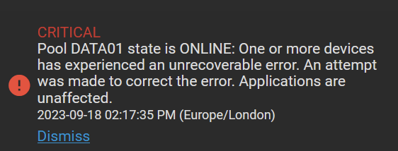

I am now running a scrub on the pool which is triggering a lot of email alerts.
Pool DATA01 state is ONLINE: One or more devices has experienced an
unrecoverable error. An attempt was made to correct the error. Applications
are unaffected.

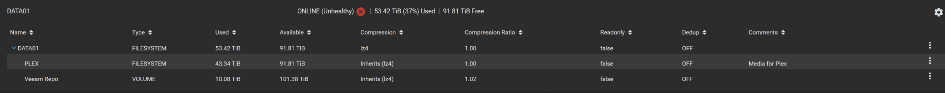

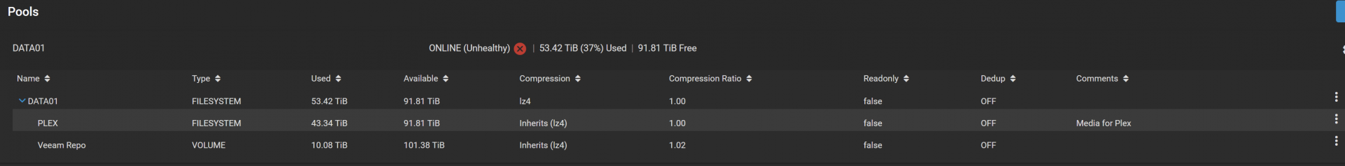

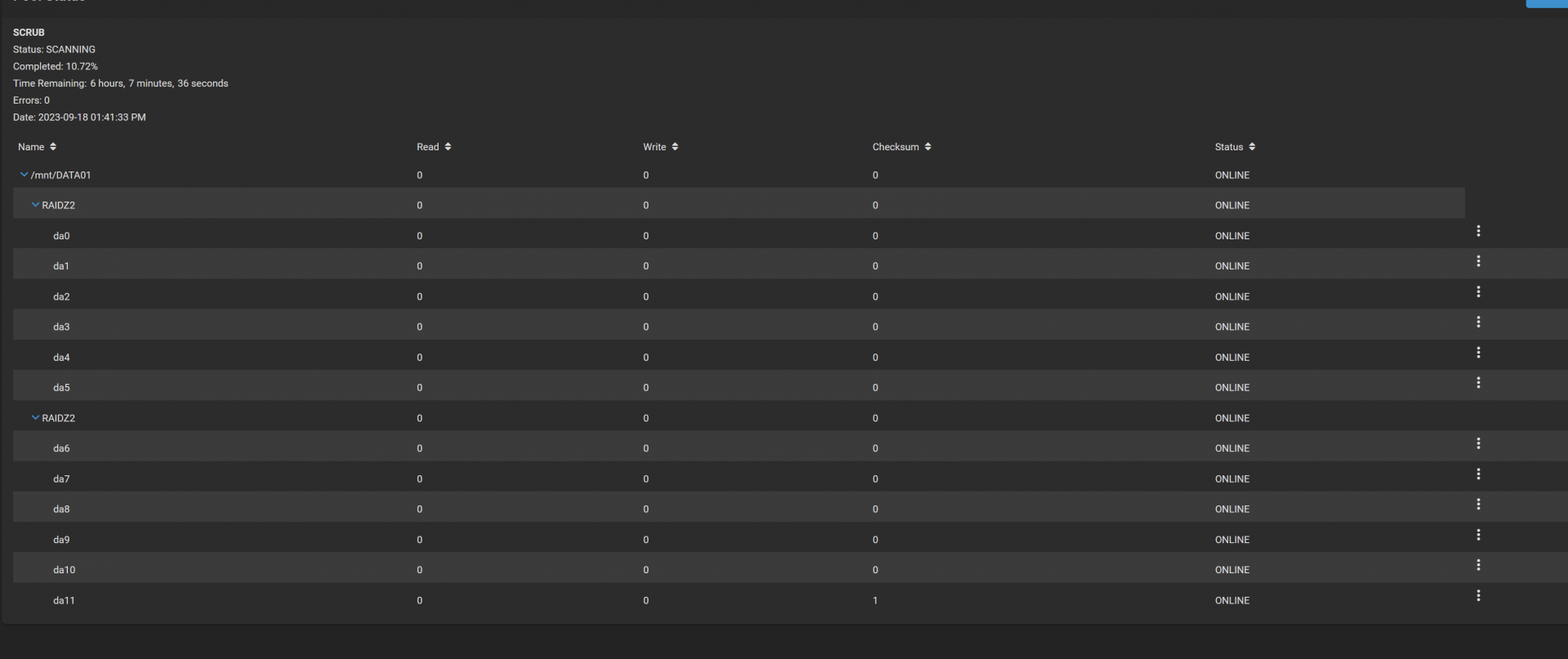

The Scrub is currently at 10% but the pool has gone unhealthy now. But if i check the pool status all disks are online.

I believe that drive it states that it is repairing is the one which was having the CRC errors.
Am I right in thinking the pool is corrupted or is the scrub doing its thing it fixing it etc?

is da11 a drive you were having issues with? That is reporting a chksum error.
Keep an eye on that - if it increases you still have a problem. Let the scrub complete and then have a look
