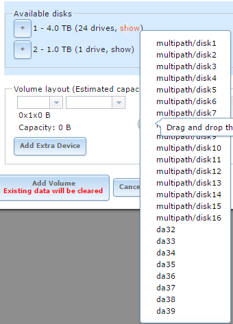

Ooo, yes, very excellent. Nice to be using the correct command. Now moving on with the issue at hand. I was able to wipe every disk in the system (except the OS), and destroyed all multipaths, then rebooted the system. I was hoping to see all of my disks showing up once again under "Disks" within the GUI rather than multipaths. I was however disappointed. This is what I see whenever I try to create a ZPOOL:
Notice the 16 drives that were once a part of a ZPOOL. They all work just fine. I can select disks 1-5, 6-10, 11-15 and create a ZPOOL (3 VDEVs of 5 drives each). I can even add disk16 to the ZPOOL in it's own VDEV (Hah, that would be really bad). What I cannot do is join any (or all) remaining disks to the ZPOOL. I have even tried deleting everything, restarting and attempting to create a ZPOOL using any of the (daXX) drives or any combination of them. Whenever I try to, it says to me, "Unable to GPT format disk da32".
