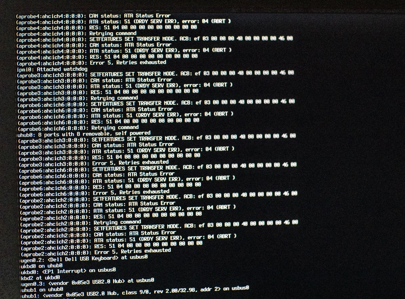

I bought a Mini XL+ shell and installed 8x8TB WD Red Plus drives in it. After powering it on for the first time (which happened the moment I plugged in the power cord) the system seems to be identifying only 2 of the 8 drives installed, in addition to the OS and L2ARC drives. There are no lights on one of the bays and during boot I see a series of ATA errors. See attached photo. Also, during boot, there's this horrible, staccato, screeching and scratching sound that puts me in mind of a head dragging across a platter. So it seems like the drive in the bay with no lights may be bad. But 6 of the 8 drives bad? That doesn't seem likely. I rebooted, of course, which involves spinning the drives down and then back up again so quickly it kinda makes me uncomfortable, tho it may be normal and fine, and I shut it down and reseated all the drives as well but there's no change. I'm not sure what else to try. The system is running FreeNAS 11.3-U5. I figured out how to upgrade to 12 so I went ahead and did that. Now it's running 12.0 U2.1. Still only two disks visible tho.
Any suggestions would be appreciated!

Do retail WD Red Plus drives also have the 3.3v PWDIS (power disable) pin? It's possible that's what's shutting them down, but why it would hit six out of eight and not all of them I'm not sure. The "noise on startup" concerns me, could be a fan but if it's a drive making that sort of racket it's almost certainly dead.
I would second the recommendation of @blanchet to contact iX support directly for the hardware issues.

I purchased the case new, directly from iX via their website. I've been in touch iX support. After sending them some debug logs and following the troubleshooting steps they recommended it looks like I really do have 6, maybe 7 bad drives here. I pulled all the drives out and added them one at a time and four of them make the scratching/clicking sound and then fail to mount with the same error message in the photo. Two more sound like a jet engine spooling up when I plug them in, which is where the "microwave on high" effect was coming from, and also fail to mount. Of the two that do mount, one of them is also making the same scratching/clicking sound as the others but not quite as bad.
I wonder if maybe they were on a truck that wrecked during transit or something like that. A 75%+ failure rate is crazy. Whatever happened, it seems likely that the two that mount aren't exactly in perfect condition so I'm going to send them all back.
