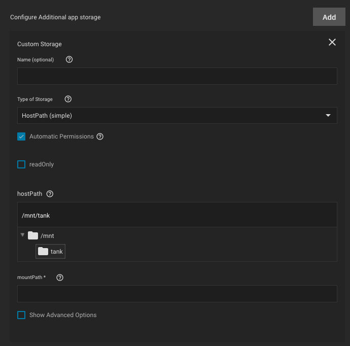

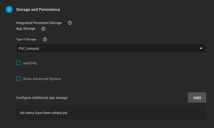

That much really is pretty simple, unless I'm missing something major (and if so, hopefully someone will correct me). When you're installing an App (or editing it after installation), step 5 is Storage and Persistence. In there, click on Add next to Configure Additional app storage:
In there, you can "add a mount point", as we would have called it in SCALE. hostPath is where the directory lives on your host system; mountPath is where you want it to live for purposes of the app:
