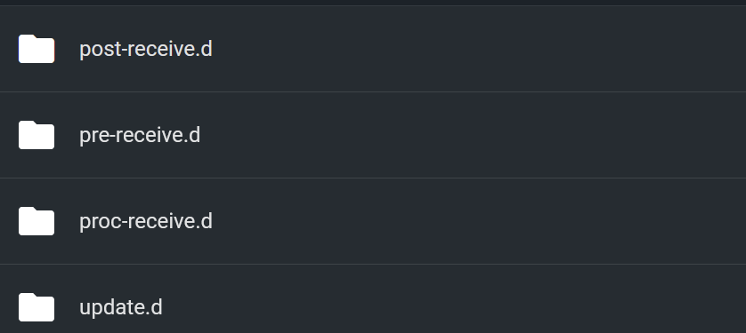

    • IMPORTANT: Go to each repository that you have, and go to the hooks folder, there are four folders in here, as follows:
      3 out of 4 folders have a file named "gitea" in there, for example, the "gitea" file in post-receive.d has the following content:
      #!/usr/bin/env bash
      # AUTO GENERATED BY GITEA, DO NOT MODIFY
      /usr/local/sbin/gitea hook --config=/usr/local/etc/gitea/conf/app.ini post-receive
      Change the first path to /usr/local/bin/gitea
      And the second path to /etc/gitea/app.ini
      Then it should look like
      #!/usr/bin/env bash
      /usr/local/bin/gitea hook --config=/etc/gitea/app.ini post-receive
    • Do the same for ALL of those "gitea" files in ALL your repositories. Otherwise you won't be able to push anything to the repo. If it still tells you paths does not exist when you trying to push. Go the trouble shooting section at the end of the guide to find your path.

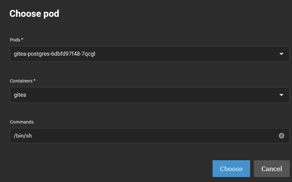

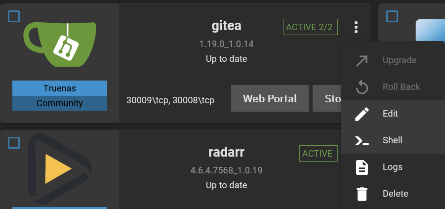

    • Enter the shell by clicking the 3 dots, then shell
    • In "Pods" select the one with postgresql in its name, click choose
    • cd to where you put the gitea-db.sql file
