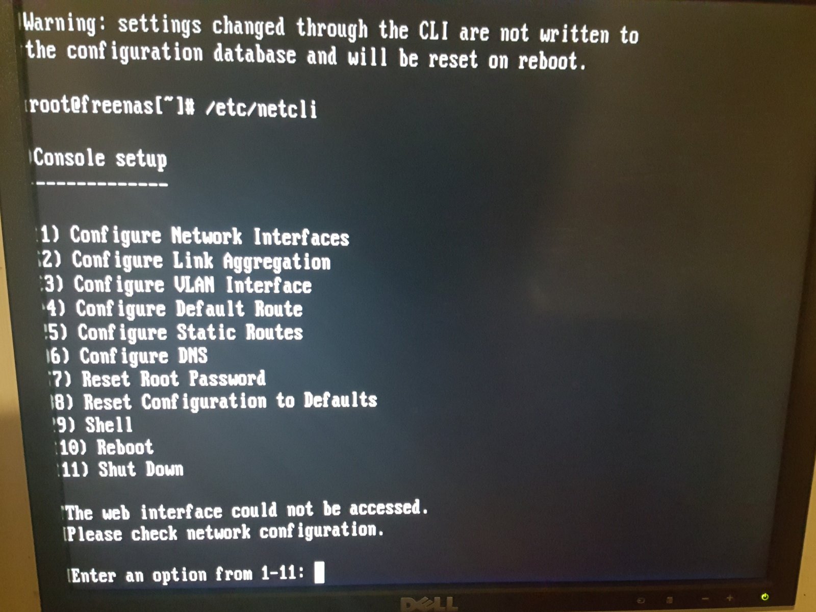

Not being funny or anything, I may not be explaining things correctly as a newb.
The "web interface cannot be accessed"

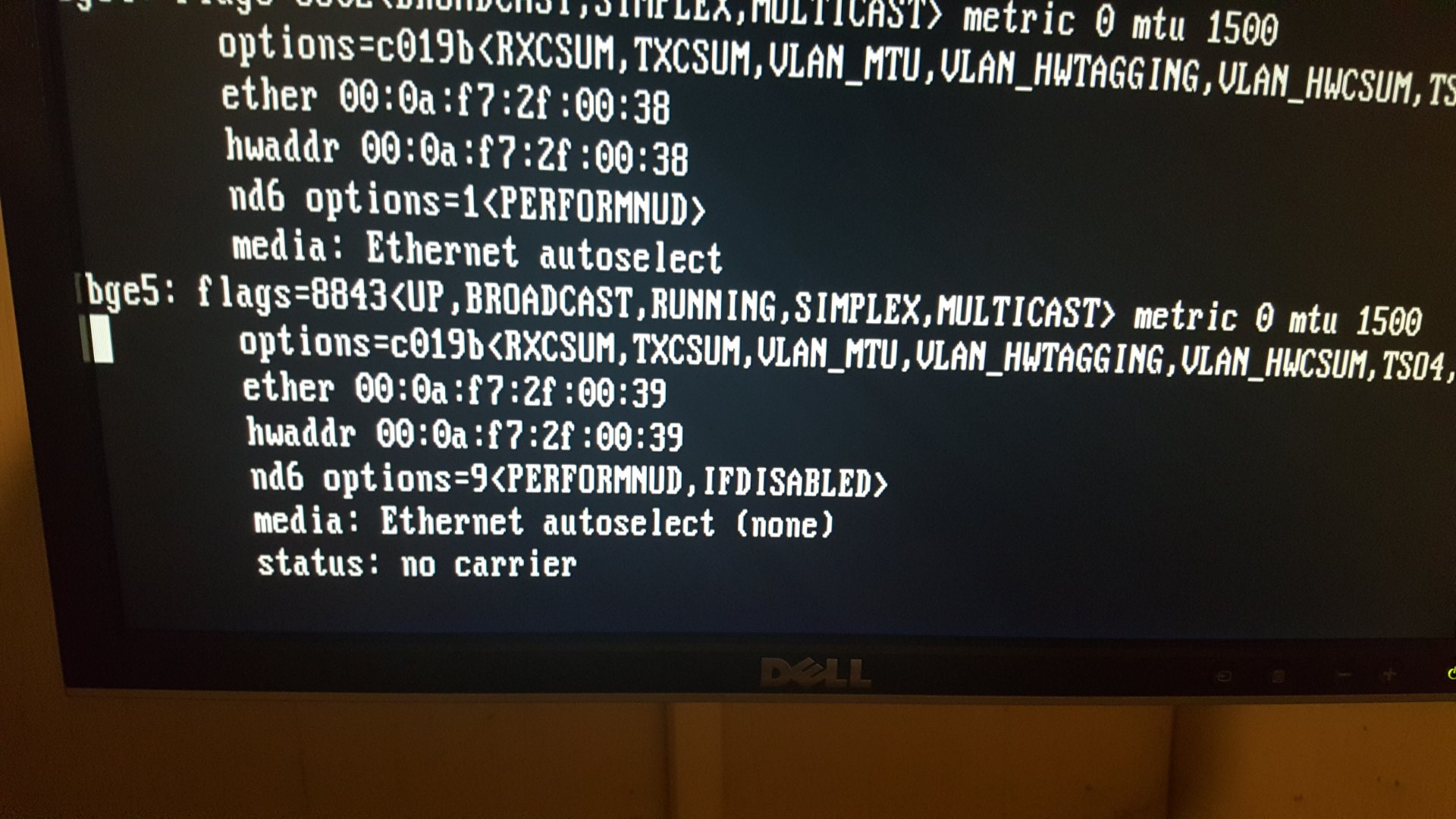

When I connect the PC to the port with that MAC and try to connect, I get the same results as I have been. Running the command again, the 100base TX disappeared.
What same result? Why is the PC disconnected? Leave it on the port that gives you the port that provided you with the output you earlier gave the screenshots for and issue the commands.

That is what I have done. I have not moved any cables since the earlier test when you commented on the bge5. Running those earlier commands again, bge5...
