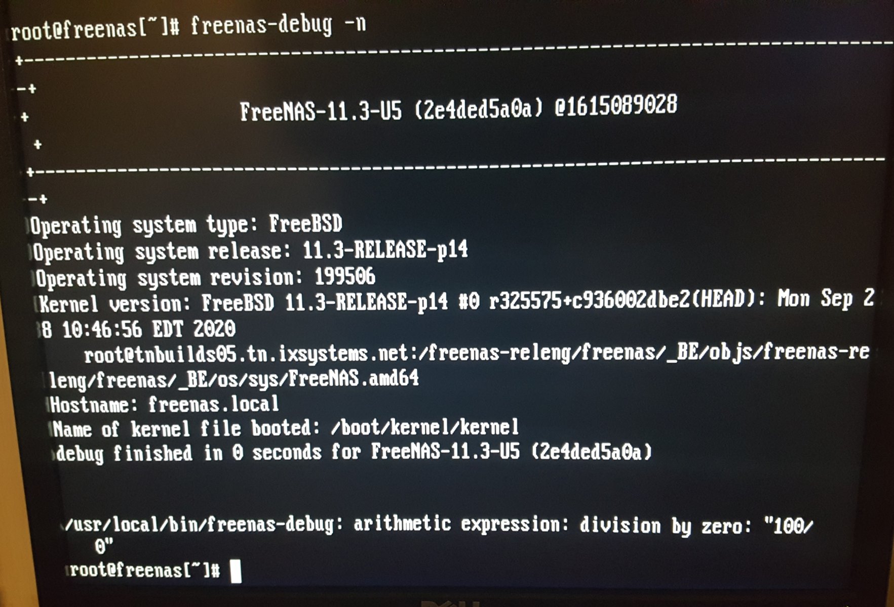

After looking thru some shell commands, I tried freenas-debug -n to see what would be revealed about network configuration. Not quite sure how to take the limited info shown.

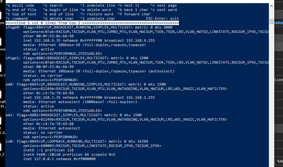

You can save the ifconfig info to a file with ifconfig >mytestfile this will create mytestfile in the current folder - use the editor ee to look at it - ee mytestfile - you will see all the commands for the editor ee as the header to the file's data.

You already showed a screenshot at the command prompt after you ran freenas debug -n.
I assumed that was the ERemote Screen you can access through idfrac, because FreeNAS is there running and you have the command prompt.

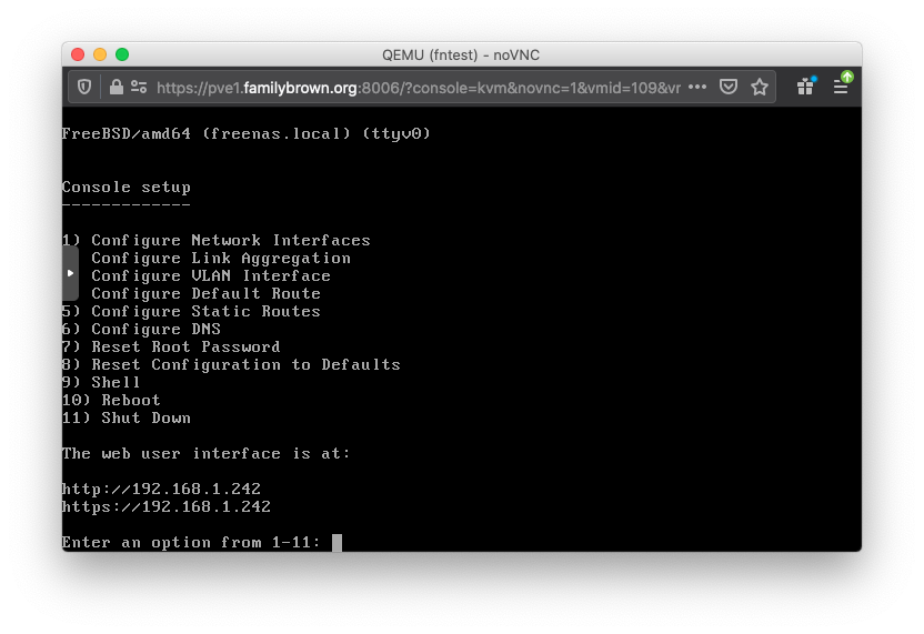

Wherever that was, go back to it and run ifconfig >mytestfile When the command prompt returns, type ee mytestfile and the file should open with a display in the editor "ee" and all its commands displayed in the header - here's mine from my NAS4 Freenas machine:
To get out of t he "ee" display, exit with the Escape key folloed by the Enter key. To move around use the arrow keys.
Post the contents of the file here.
If at some point you wish to go from the command line in the shell to the console menu, then put /etc/netcli at the command prompt.
To get back from the console to the shell command line,. use the option "9". (no quotes).

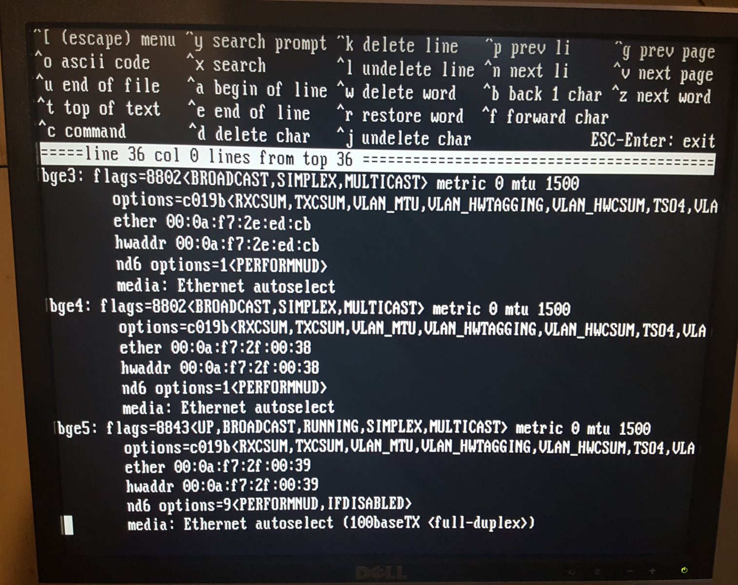

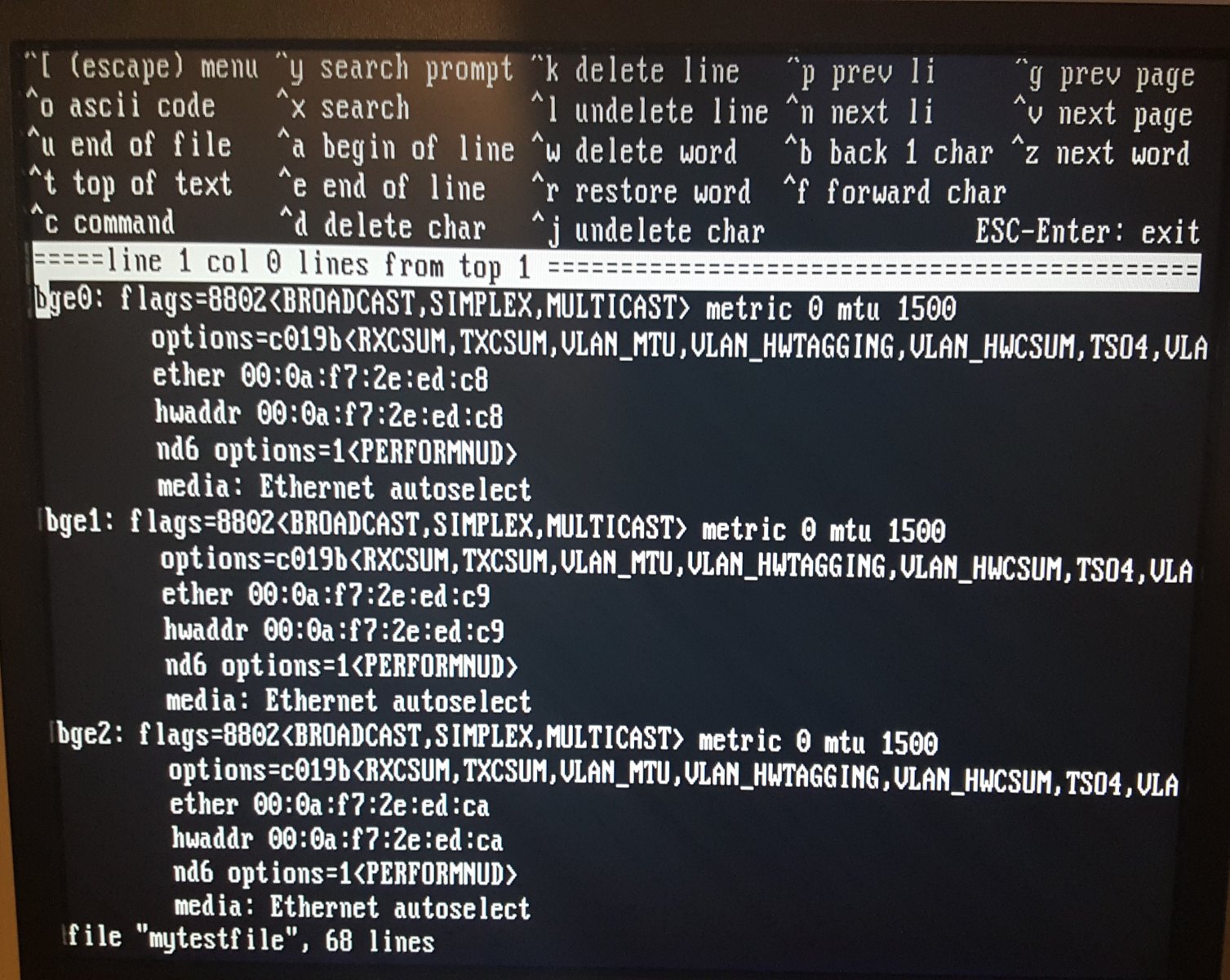

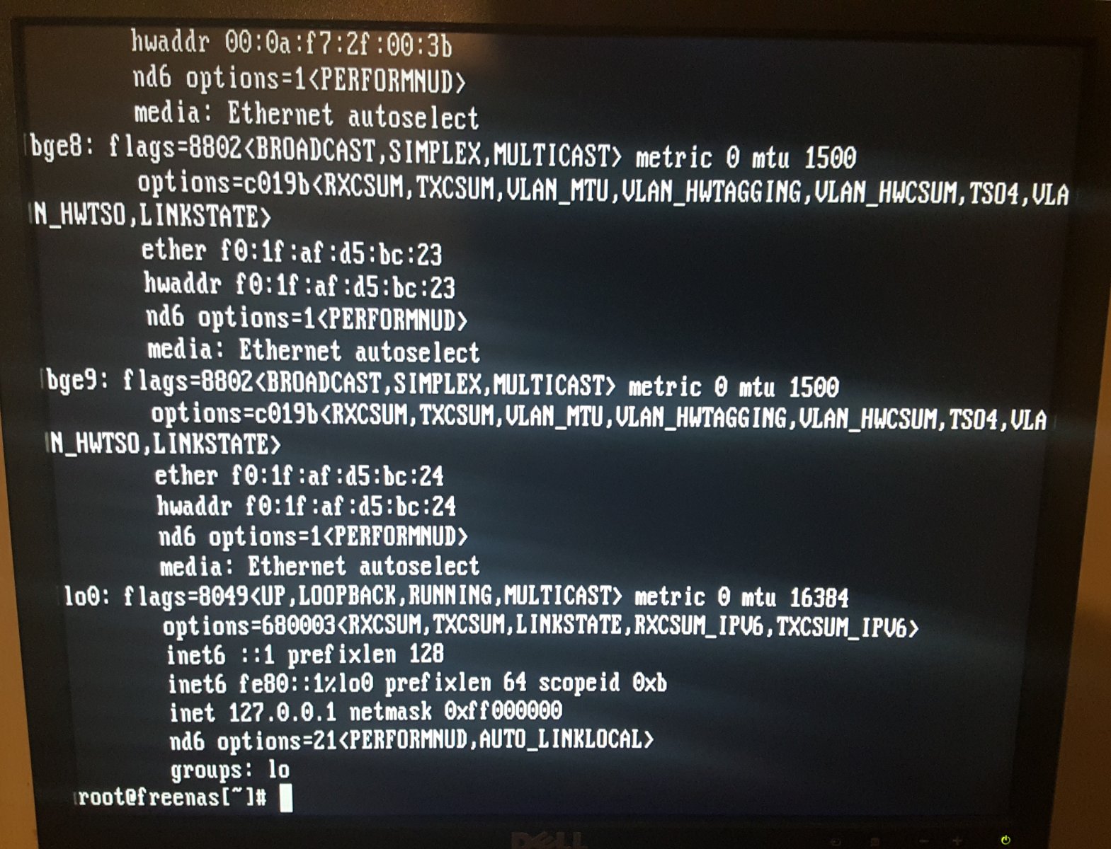

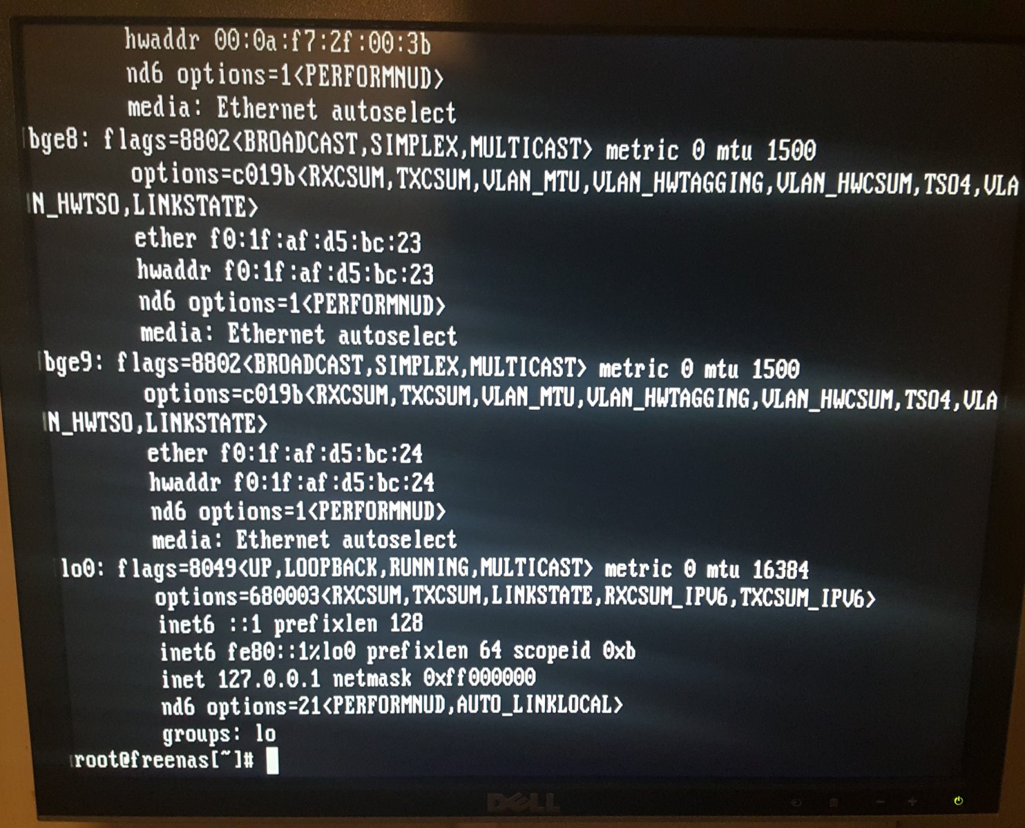

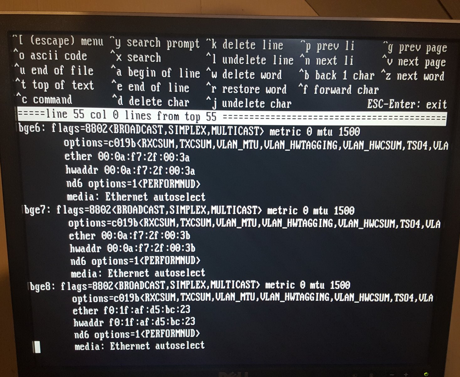

Mrfix71
Member
Dec 25, 2020
29

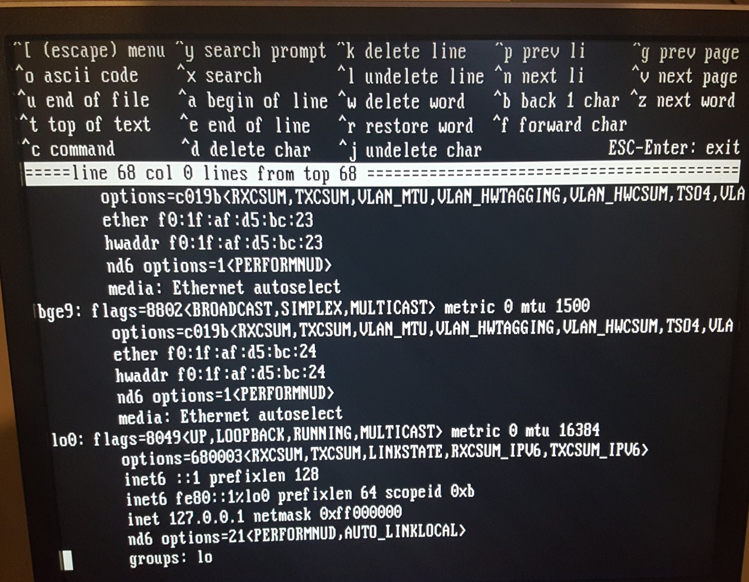

Using the iDrac remote viewer is another issue but much less important. Haven't been able to open the jnlp file that it generates and has not been a critical point yet. But here are the results of running those commands:
Thanks again Redcoat. That was very helpful.
Being able to reference the MACs on the screen from those I keep on my master device list will help narrow down the ports.
Redcoat
Dedicated Sage
Feb 18, 2014
1,891
It looks like you are hooked into interface bge5 at present.
What does the consoled display show? use /etc/netcli
