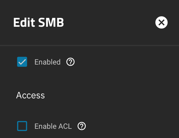

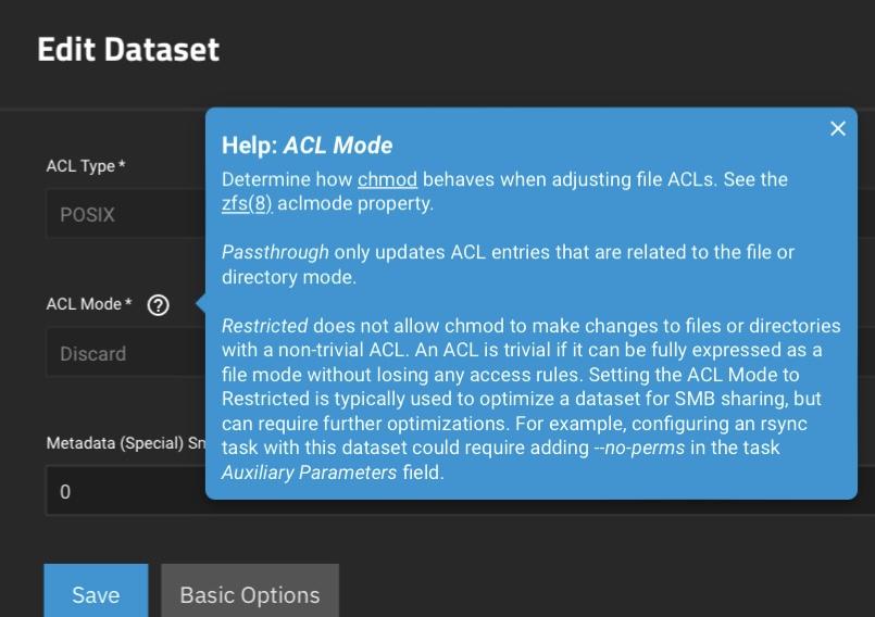

I don't think you need ACLs for this basic scenario. I have removed all ACLs from my datasets and just use regular Unix filesystem permissions. Have zero trouble using these files inside jailmaker jails. I can even share these datasets simultaneously via SMB with ACL disabled.
