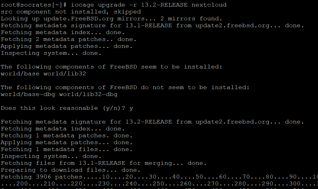

I created a jail for my nextcloud instance. It is currently on 13.1-RELEASE and I'm trying to updated to 13.2-RELEASE to match the truenas installation as i have done many times before but this time i'm stuck and i need some advisement.
I did the
iocage fetch
and selected 13.2-Release
then i stopped the jail
iocage stop nextcloud
then i ran the upgrade command
iocage upgrade -r 13.2-RELEASE nextcloud
and this is what i got

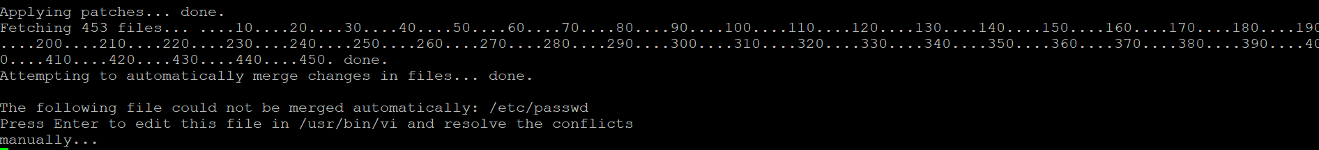

This is where I'm stuck. I honestly don't know how to manually "merge" the file /etc/passwd or why am i required to do it this time.
When i press "Enter" I do get into VI and i see the file. But, then again, i don't know what is that i need to copy, or paste, or where, or how to save it.
Has anybody experienced this before?
I searched on the forum but got no luck.

You get a file with both versions intact framed by lines similar to:
presenting you the "old version" and the "new version". Sometimes the old version is empty, which means there are only lines to be added.
You need to edit these out and from the parts construct the version of the file that you want to save. Then save and exit vi. This can happen - and frequently does - for every major FreeBSD update. man etcupdate for details.

@Patrick M. Hausen thanks for the advisement, it pointed me in the right direction. During my research i found the following thread on the freeBSD forums that explains this process a bit more Manually Merging Files
I'll explain what i did to solve my issue for future reference to me and others that may be in this situation. It will be extremely basic but i feel that is what somebody like me needed to solve this.
Basically, during the jail upgrade, freeBSD tries to replace the old files with their newer version. But sometimes the contents of the newer files are a bit different than the existing files inside the jails, that is why freeBSD asks file for manual intervention.
In my case I got the following warning during my jail upgrade
The following file could not be merged automatically: /etc/passwd
press Enter to edit this file in /usr/bin/vi and resolve the conflicts
manually...
So, i pressed "Enter" as per the instructions and the VI text editor opened with a file to modify. This is the part that where i needed help.
This file has 3 parts as follows:
  1. Part 1: is enclosed between <<<<<<< current version and =======. It has the lines of code in the old file that are different from the new file.
  2. Part 2: is enclosed between ======= and >>>>>>> 13.2-RELEASE. It has the lines of code in the new file that are different from the old file.
  3. Part 3: is everything after >>>>>>> 13.2-RELEASE. This part contains the lines of code that didn't change between the old and new file.
In my case the file looked like this (contents were edited since this is the passwd file)
# $FreeBSD$
root:lines1:lines1:lines1:something1
root:lines2:lines2:lines2:something2
>>>>>>> 13.2-RELEASE
toor:lines3:lines3:lines3:something3
daemon:lines3:lines3:lines3:something3
operator:lines3:lines3:lines3:something3
Since this is the passwd file, i figured i should keep the lines of code from the old file in order to keep my jail operating properly. So i deleted the following lines (by putting the cursor at the beginning of each line and using the VI command dd to delete):
>>>>>>> 13.2-RELEASE
the end result is a file that looked like this
# $FreeBSD$
Then i saved and quit the file (by using the VI command :wq).
This solved my issue.
