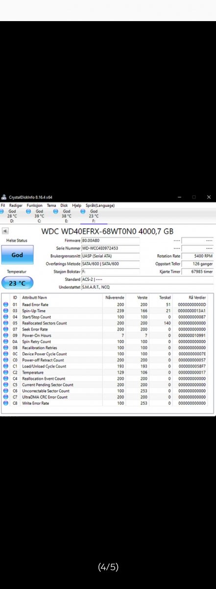

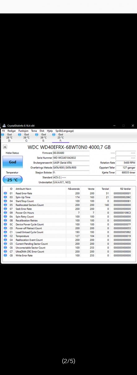

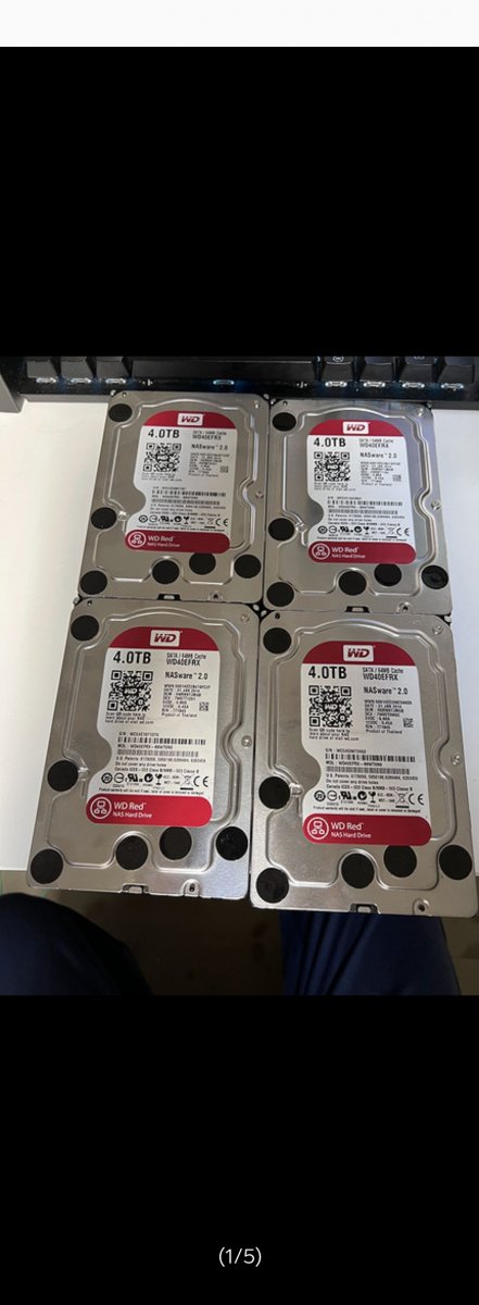

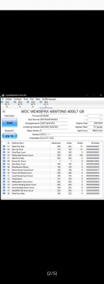

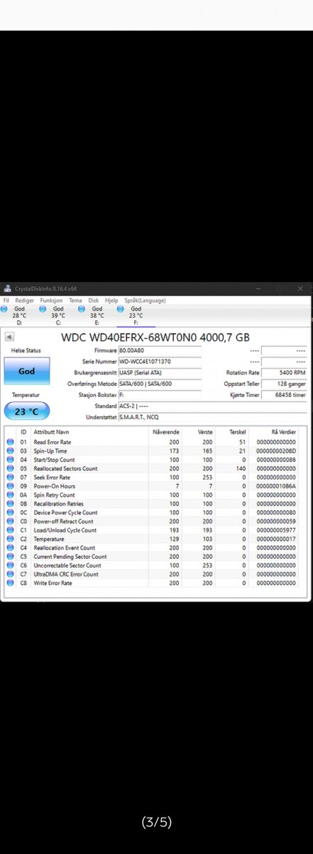

What are the model numbers of your Red drives? I suspect you may be running SMR drives, which would exhibit this performance pattern.

Got some photos here:

OK, they're the CMR models, so that's not a problem. How is your pool constructed? For iSCSI, you'll want to use mirrors instead of RAIDZx. Also, you have less than the minimum required RAM of 16 GB.

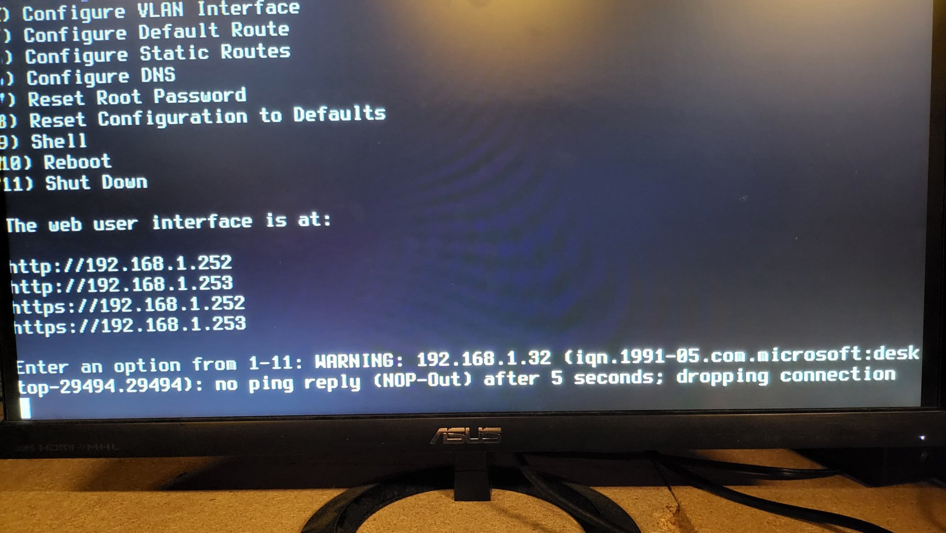

When I was going to check on my server this was at my screen.
Don't know if this is normal or is a part of the problem?

jgreco
Resident Grinch
May 29, 2011
18,680
That's not normal and looks like a network issue.
It's not a network issue. iSCSI has a five second timeout, and if operations are not being served expeditiously, you will get these kind of timeouts.
RAM: 12gb
If you are pushing lots of traffic at the server with iSCSI on only 12GB RAM, I'd say this is totally expected. After awhile, the system suffers fragmentation and starts to suffer from an inability to rapidly allocate new blocks for writes, which tends to cause iSCSI to freak out.
