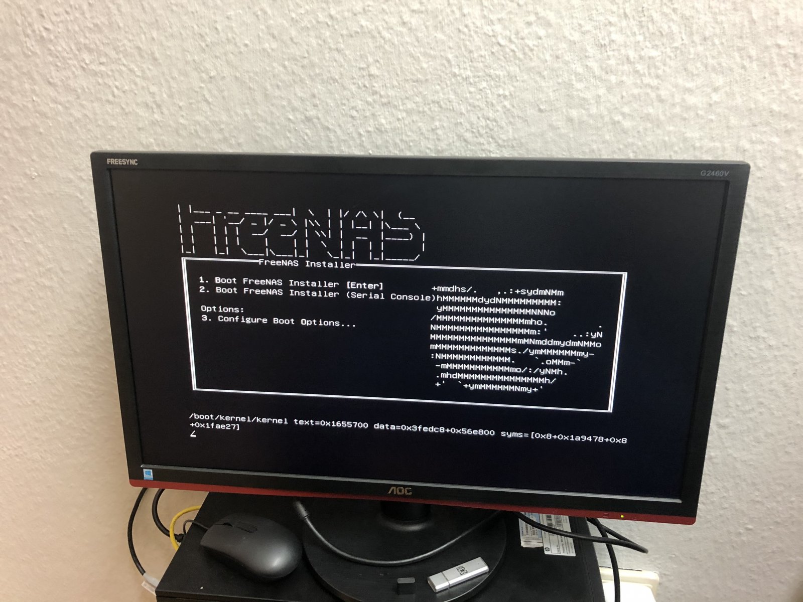

Hello,
i am trying to install Freenas 11.3 on an old pc
its a hp compaq elite 8300
- Intel Core i5-3470
- 32 gb of ram
- 1x 256 gb ssd from crucial
- 2x 8 tb wd red plus
i downloaded the iso file and made a bootable usb stick with rufus.
Anyway i haven't even got passed the installer because i get to the installation screen i press enter and the computer keeps rebooting and comes back to the same screen. i also atached a screenshot of the screen i am talking about.
i also tried other boot options but it still does the same.
Please help.

This probably isn't much help to you, but I also have a HP Compaq Elite 8300 that I've been using for another role. It recently became free, so I thought I would put FreeNAS on it.
I have exactly the same problem, to the letter. I stripped the system down to bare bones, still have the same problem. I've tried FreeNAS 11 and the new TrueNAS build.
I installed FreeNAS on a different system, then plugged in the disk, and with no surprises at all, the installed image reboots at roughly the same time the installer image does.
I'm sure my hardware has no issues, I've used it for a variety of old jobs around the house. I'm now looking for an alternative to FreeNAS/TrueNAS due to lack of hardware compatibility from the product.

While it's disappointing nobody replied to your post for several weeks here, I can tell you with some confidence that the problem is with FreeNAS having a wonky and unreliable/dodgy UEFI implementation.
When the 8300 boots, hammer the ESC key, then press F9 to get to the boot menu, then choose legacy boot - don't boot from the USB device in EFI mode. You should be able to get to the installer then. Although, this experience should be enough of a warning for you that FreeNAS isn't meant for a wide variety of hardware/use cases. Maybe this is so they can sell more of their dedicated hardware?

Hello to everybody,
i only saw the reply now. In the meantime, i solved the problem. here is my workaround:
After that didn't work i thought about a week ago to try something else and namely I installed version 11.2 instead of 11.3 and that booted and I managed to install Freenas --- Yeeey!
There is definitely something in the 11.3 version that is not in the 11.2. But I have no idea what it is.
Hope this helps other users.
Mr.AbKaRy
Newbie
Feb 13, 2021
The problem is in the truenas uefi implementation ... used bois instade and it works like a charm now on the lateset available version
