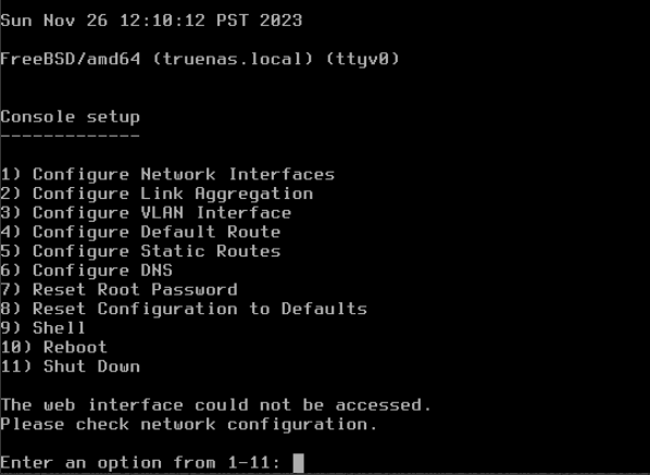

New controller arrived. Fitted. Seems to be working.
As a result I was able to follow the instructions on this page
and all the way down that page, everything worked as advertised.
Thanks to the new controller, I could see the 2x1.8 Tb drives separately, as well as my target 240Gb SSD system drive

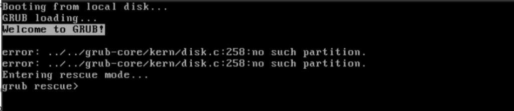

I was able to install TrueNAS on the SSD but on the eventual post installation reboot, instead of presenting the screen promised (see under the Heading "Fire up TrueNAS" in the link above)
I was presented with:
I have no idea how to react to that. I have repeated the installation a couple of times just to ensure I didn't misconstrue or veer from any of the instructions. Results consistent.
Suggestions please

This is the TrueNAS CORE section of the forum. TN CORE does not use grub. Did you install TN SCALE?
jgreco
Resident Grinch
May 29, 2011
18,680
It says FreeBSD a few images above. I'd guess that a previous Linux installation is interfering and that maybe the boot device is set up incorrectly.

@Patrick M. Hausen "This is the TrueNAS CORE section of the forum. TN CORE does not use grub. Did you install TN SCALE?"
not entirely sure how I can answer that question. So far as I recall, I downloaded the iso from https://www.truenas.com/download-truenas-core/
so I believe it should be the Core. However, see below, re the possibility I have some left over remnants of previous linux installation.
@Ericloewe "How's the boot disk attached? Same SAS controller as the other disks?"
Yes
@jgreco "It says FreeBSD a few images above. I'd guess that a previous Linux installation is interfering"
entirely plausible.
Thought I'd completely eliminated all traces of the previous Linux install, by deleting the partitions in the RAID controller, before I replaced it, but I did notice - with astonishment - on my first attempted RE installation of trueNAS. (after I'd missed the F11 prompt to go to the boot menu, so it tried to fire up from (an) HDD) that it spontaneously started reinstalling the OpenSuse linux OS that I'd been wrestling with for a couple of weeks before being gently nudged in the direction of TrueNAS.
Not sure how I can scrub the disks in a system with no OS installed. I could remove the drives, put them in a caddy and perform a partition wipe under Windoze, but I'm not sure if that would do the trick.
Suggestions? I'm inclined to remove all the drives, Wipe the SSD in my caddy, put that one back in, on its own and attempt a new installation where it can't possible read anything from another drive. But, I would like confirmation that, if I do that, I can then put the other drives back in, before booting the newly installed TrueNAS system and be confident that TrueNAS will still be able to recognise the newly installed drives so I start working with those. Can't imagine why it wouldn't but it would be good to have that expectation confirmed.
Depends on what you're comfortable with. With a Linux LiveCD, for instance, the instructions to deploy a new root on ZFS system have a few steps to ensure disks are truly empty, e.g.: https://openzfs.github.io/openzfs-d...22.04 Root on ZFS.html#step-2-disk-formatting
You can accomplish the same from the TrueNAS install environment, but I'm not sure what tools are and are not included.

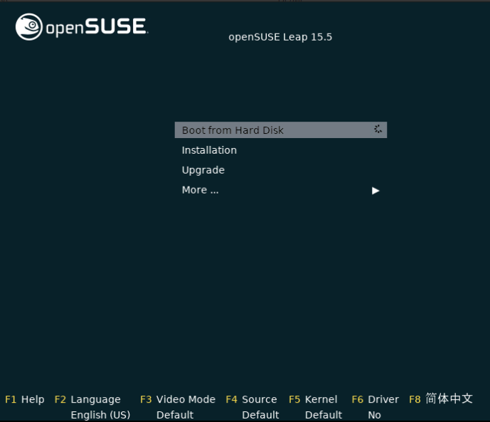

I used Aomei's partition assistant to delete the partitions on the SSD and wipe the drive with zeroes. Short of wire brush and dettol, that's about as clean as we could reasonably demand. Spose I could have gone for a DoD wipe but I'm not trying to avoid an NSA inspection!
Anyway, it worked. What I did discover is that there are two further steps which happen between reboot and the success screen which displays the web interface ip, viz:
which surprised me 'cos I didn't think TrueNAS was based on OpenSuse.
On selecting "Boot from Hard Disk" it was followed by another menu which defaults to "Boot TrueNAS" which it did before I could capture it

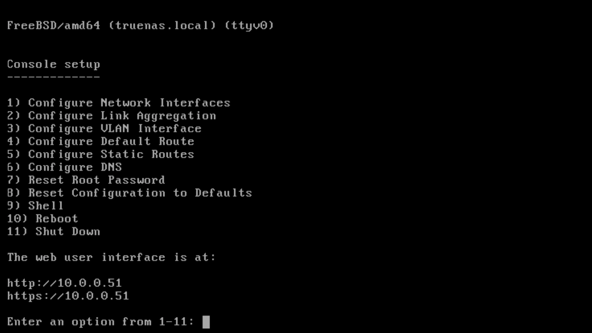

nanycase, I managed to get access via the web interface and started exploring the options. Set up the first group and first user just to get a feel for the interface. Then I went looking for how to configure the two drives into the TrueNAS RAID system and could find mention of Pools etc but nothing obvious telling me how to create the RAID.
Is there an idiot guide to that? Is it something I should perform from that "preboot menu" above (eg the Installation option)
and, after that, twould be useful to have another idiot guide to we set up automated connections from windoze workstations to the new filestore.
