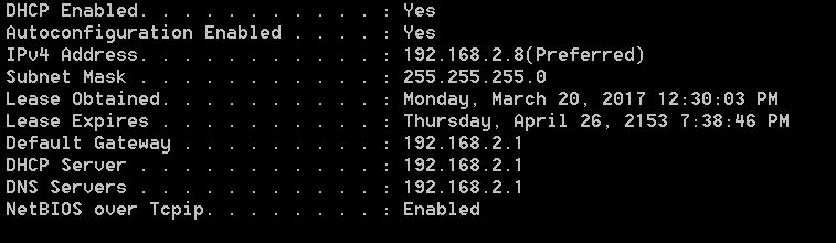

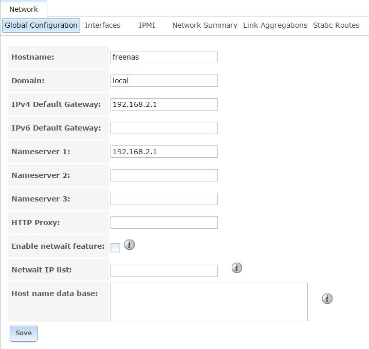

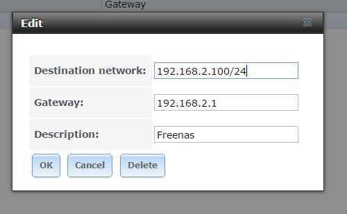

I also setup the global config with an IP4 gateway and nameserver 1 shown in the static 1 photo. I got that info from running ipconfig in the command prompt, that output is in the picture static 3. Lastly I setup a static route with the destination network as 192.168.2.100/24, gateway as 192.168.2.1 seen in static 2 picture. I am not sure what I have missed, any help would be appreciate?

Odd that the 'old' address (192.168.2.14) is showing up... can you access the GUI via that address? Try deleting the existing config to start with a clean slate.
Make sure the IP address you're assigning (192.168.2.100) is not within the range of addresses assigned by your router via DHCP.
Your nameserver and gateway setup in Global Configuration looks good.
You don't need a static route...

I just set up static in v9.10. I did just as you did in your static 2.jpg and the same in your static 1.jpg....except the nameserver 1 is : 208.67.222.222 and nameserver 2 is: 208.67.220.220. (as per Open DNS)

one more thing:
network:
static route;
add static route
you should have:
destination network: 192.168.2.100/24
gateway: 192.168.2.1

The OP doesn't need a static route.
