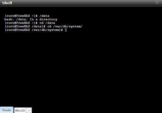

That's what I'm trying to do. Not working for me when I go to Shell and go /Data. I try to do a DIR but nothing.

Drop a bit further down the post - you need to go to /var/db/system

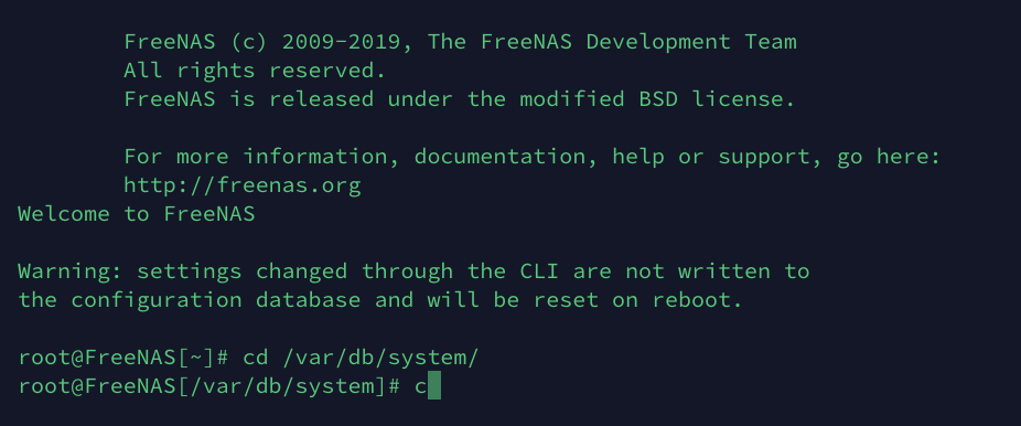

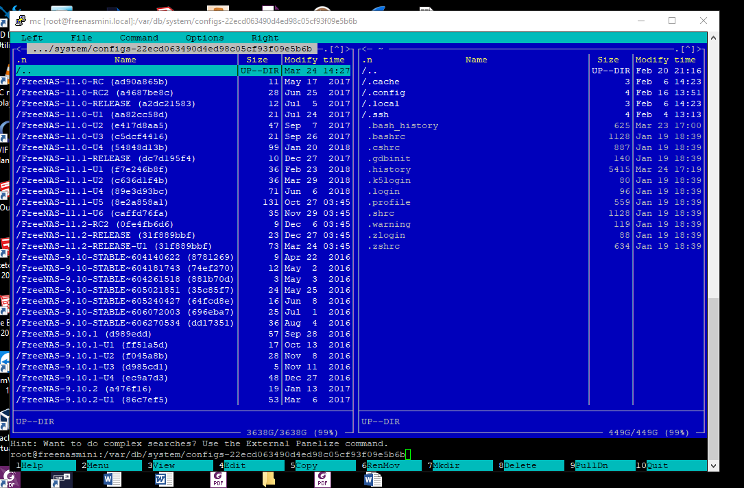

Yep I did that. Then what?
I'm doing this from the Shell in the web browser

Then open the directory configs-averylongnumber and find your dated configuration file that you want to reload.
If you have trouble navigating this from the shell, you might want to consider using SSH and Midnight Commander (mc) to get to the path to enter to upload:

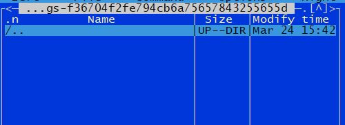

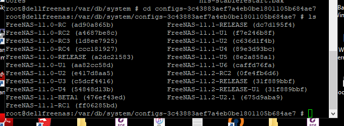

When you're in the prompt (root@FreeNAS[/var/db/system]#), what's the next command?
ls to list the contents and find the full directory name of configs-averylargenumber
That is lower case "ls"

Yep, I got that but what is the command?
- I SSH into the server
- I enter my Name & PW
- Then type: cd /var/db/system/
- Now I'm on line root@FreeNAS[/var/db/system]#
- What's s my next command?

the command is "ls":
I just looked in both tghose and my configs are in the first so run the cursor across it to copy it
type cd (space) right-click for
Hit carriage return, then ls
and there are your config files

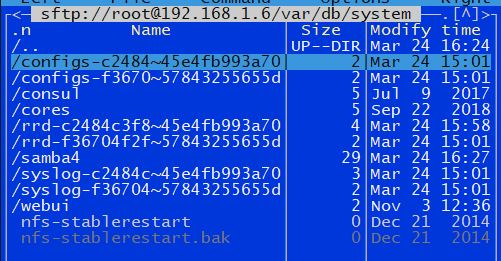

Well, those folders are dated today. I guess that you did not have your configuration stored on your pool, but still on the boot drive as was the earlier default. Best thing to do now is to treat it as a blessing in disguise, an opportunity to have a freshly configured install...

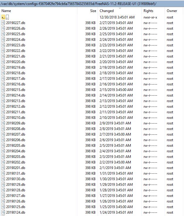

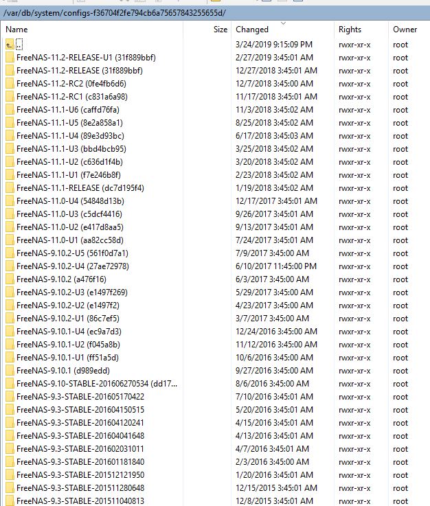

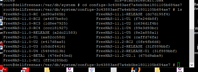

I think I'm getting somewhere. I download WinSCP and I can see it here.
Getting warmer... What now?
