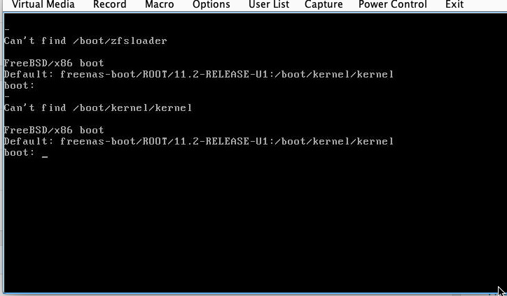

First I upgraded to the latest 11.1 (U6?) and it booted just fine into FN. Then noticed 11.2 stable was available and upgraded via the same GUI and it booted into "getty repeating too quickly on /dev/ttyv0, sleeping 30 secs"
Rebooted and watched FN shut itself down syncing, etc... On the next reboot I got the screen shot below. Tried rebooting several times with no change. ALL WAS RUNNING FINE until the 11.2 upgrade.
Suggestions?
Thank you.

is there a way to pull the config file from the old usb boot stick before I try to install the 11.1u6?
lmannyr
Oct 11, 2015
198
I removed the 2 original USBs that were working prior to the upgrade for safe keeping to hopefully recover the config file if it is saved there.
Next, I installed 11.1U6 into a different USB and have FN up and running now. Pool is also up without any loss of data. Where can I find the config file from prior to the upgrade? Where does FN save/backup the config file?
