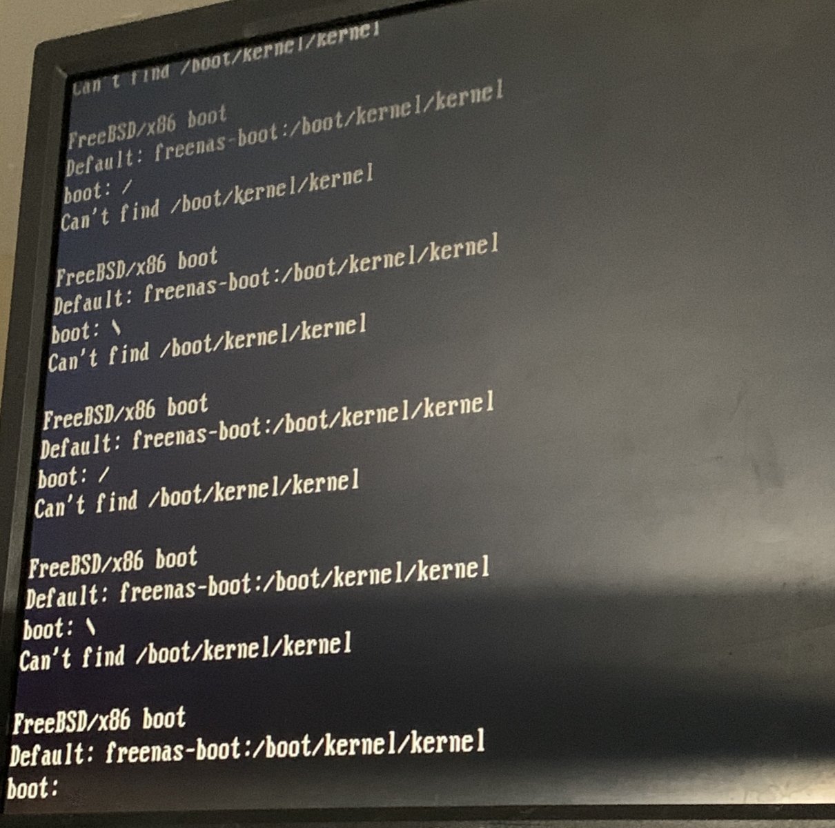

Hi Guys, I upgraded from 11.1 to 11.2 and now I can't boot up. My boot device is the 16GB thumb drive. I have over 50TB and worried AF as what's going to happen. In the last 5 years of running FreeNas, I never had a problem upgrading to the next version. I'm attaching a picture of the prompt I get when I reboot.
Anybody with a resolution?

Using the bootloader, can you boot back into the 11.1 environment, or you don't get that far?

Do you have the config saved somewhere? If so, build a new 11.1 boot disk (preferably using a different USB stick) and restore the config to that. You could start with 11.2, but this way, as long as you don't upgrade the ZFS flags on the volume, you retain the option of downgrading back to 11.1.

Reinstall 11.2 on a new usb. If it boots import your pool. If it doesn't boot go back to 11.1 and import your pool.

So you did upgrade from 11.1 to 11.2 at least two weeks ago? If so, you've been running on 11.2 for a couple of weeks and it's only just failed? If that's the case, likely the issue is with the USB stick.

Yep. You know what, now that I recall, I remember getting a red notice saying that the boot device was degraded.

Settings are part of your config file. Plugins/jails and data are part of the pool. If your system dataset was on the pool you can recover your config file and be back to normal. If it wasn't then you will have to reconfigure everything.

Your data and jails are in the pool and not the boot device so they should be fine. Once you import the pool, you may be able to recover your config as well. See entry #10 above.

The boot media is separated from the storage pool to protect your storage, so your data should be safe, it is just a matter of fixing the boot media. We have seen a lot of failures of USB media in conjunction with the latest upgrade.
