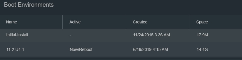

I have deleted old snapshots and verified that the user data is not on the boot partition, but my boot image has grown overnight.
this is preventing me from upgrading further.
Are there any other suggestions as this unit only has a 16G boot partition.

Are you storing anything in /root? You have put something on your boot device.
