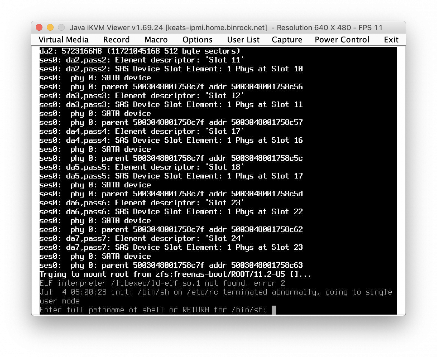

A little background. My server was running 9.3 for a long time. Several months ago I upgraded to 9.10, and it has remained stable in the interim. Today I upgraded via the GUI to 11.1-STABLE, which seemed to go smoothly, and then I immediately upgraded again to 11.2-STABLE. When rebooting after that upgrade process had completed, the system wouldn't boot, with the error mentioned above:

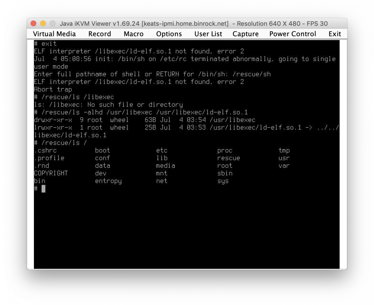

If I enter `/rescue/sh` as my shell, I get dropped into a single user mode rescue shell. I used `/rescue/ls` to poke around the filesystem, and I see that the entire `/libexec` directory seems to be missing, but I DO see a `/usr/libexec`, which does contain a file called `ld-elf.so.1`, though it seems to just be a symlink to the nonexistent `/libexec/ld-elf.so.1`.
