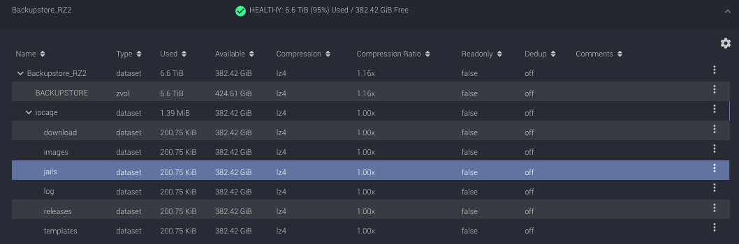

Skynet3020
May 21, 2015
17
Hi guys
on my system i'm at 90% (Backupvolume) there are 7 HDDs (2TB) in a Raid Z2, what happens now if i replace one drive from 2 TB to 4TB.
gives this a little space ?
or how many drives i needs to replace, that i have a litte more space ?
9,700
If your pool is just the single RAIDZ2 VDEV, you will need to replace all 7 disks before you see an overall increase in size.
You could add additional disks in another RAIDZ2 VDEV to the pool, which would immediately add their space to the total, but your pool would then contain 2 VDEVs.
Skynet3020
May 21, 2015
17
ok thanks for the info, thought i too...
but one thing is curious in my system, i use on this volume only a vm disk image size 6.6TB but why it grows up ?
when I created it it was at 80%, and now it is at 95% The last warning was 91%. FreeNas say's: 382.42 GiB Free
The VM Disk says there is 361GB free
FreeNAS-11.2-U4.1
